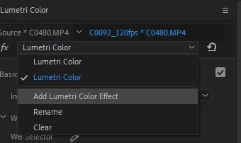

You can use multiple Lumetri layers, but the first you don't even need to apply, so that's pretty easy! Just open the Lumetri Color panel and drag the Saturation level down to zero and you have a black and white image. 🙂
Then right at the top there is a drop-down and you can "Add Lumetri Color Effect" It's easy also! 🙂

Did you notice the Three-Way Color Corrector is in the "Obsolete" folder? That's a pretty strong sign you should figure out another way. Can't you use another Lumetri layer to get the black and white for you?
September 25, 2021
I didn't realize that 3 way was in that kind of folder. I used it since it was much easier and faster when trying to make it mono. I guess I can just do that then
