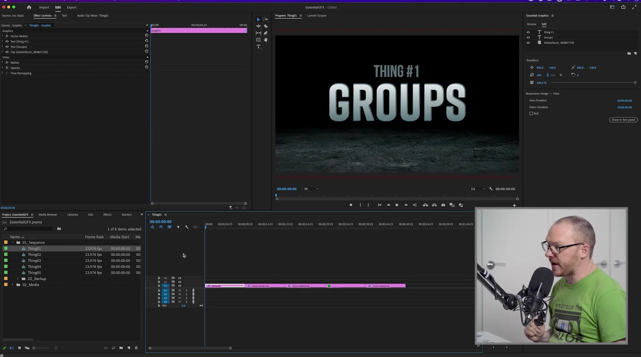

It’s much easier to handle this kind of workflow in After Effects since it lets you adjust scale in both percentages and pixels. But if you’d rather stick with Premiere Pro, you can achieve a similar result by working with layers in a single graphic, like you would in Photoshop, instead of managing multiple tracks.
Here’s a simple way to do it:
  1. Open your sequence in the Timeline.
  2. Go to Graphics and Titles > New Layer > Rectangle to create a new layer.
  3. Select the clip in the Timeline, then go to Window > Properties.
  4. Drag your Photoshop layers from the Project panel into the Properties panel (and delete the rectangle shape layer).
  5. In the Effect Controls panel:
    • You can adjust the position and scale of each individual layer.
    • Or use Vector Motion to adjust the position and scale of all the layers at once.
  6. If needed, group multiple layers together to make changes to the entire group in one go.
If you want to dive deeper, this video is a good introduction to animating with graphic layers in Premiere Pro: Animate Stunning Graphics Using Only Premiere Pro
