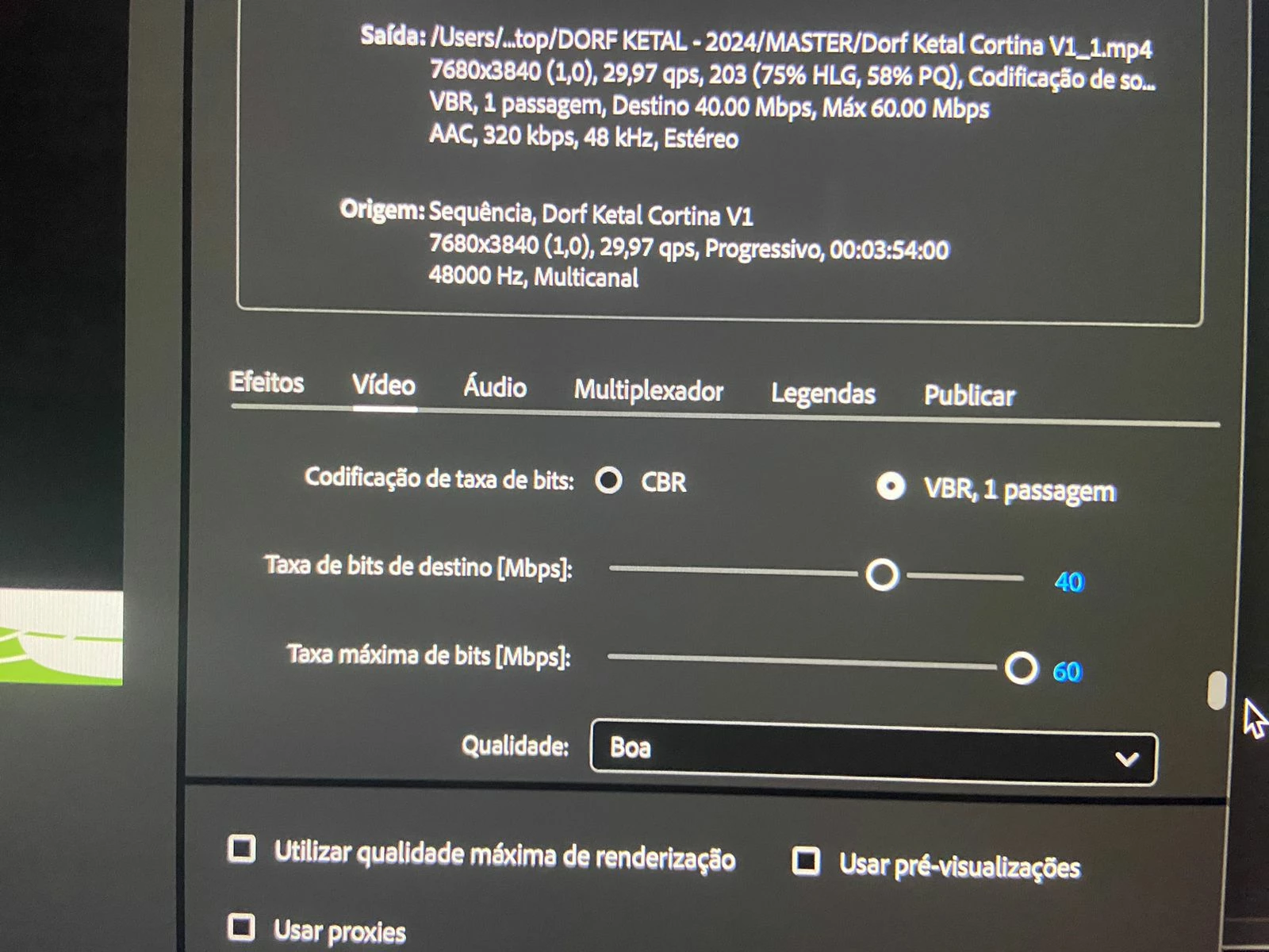

What is the Maximum Compression Rate in Mbps for Exporting HEVC (H.265) video files? Here in my version it only goes up to 60Mbps. The problem is that for video360 8k only 60Mbps is not enough. They say 120Mbps is possible, what do you see at the premiere?

Hello! Can you achieve Maximum Target Bit Rate (Mbps) greater than 60 Mbps? I didn't understand what 800 would be?
By @Luiz_Lau

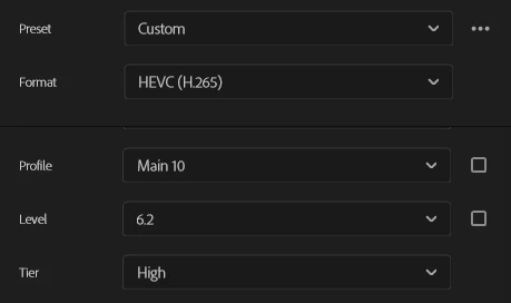

Yes, i can get 800 Mbps if i set the Level to 6.2. I get 160 Mbps if i keep the Level at 5.1. Both set to "Video is VR". This goes for Premiere Pro 24.6.1.

In Premiere Pro 24.6.1 i can bump it up to 800 if use those settings:
