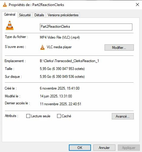

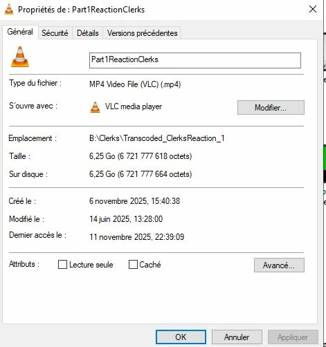

Here are the pictures of my media files.
I make movie reactions so there are 2 parts of my reactions made from my camera phone (variable bitrate) and 1 file for the movie screen recorded with OBS.
The files were transcoded from another hard drive because my SSD is new and I wanted the project to be at the same place as PP while editing it.
I don't think it has anything to do with the project though because the first time I had this issue, it wasn't a transcoded project..
I hope that's what you asked as for the pictures cause I wasn't sure..

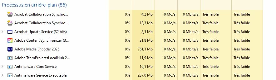

I forgot to say that I managed to unistall Premiere pro. I had to use to task manager to force shutting down something called "link manager" but I can't uninstall Media Encoder cause it says that it is active and task manager can't force shutting it down.. Same issue as last time. I don't understand why Media Encoder is still running even though the window is closed
Also update: Media Encoder doesn't appear in my task manager menu anymore but I still can't uninstall it. Same message appears.
