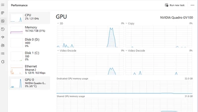

First - the CPU usage being high is not because the transition is being rendered by the CPU - it's high because Premiere falls back to CPU decoding during export if the export format is a HW encoded format. This is due to an outstanding bug where exports can fail with both HW decode and HW encode enabled during export. You can monitor HW encode/decode independently in windows task manager if you want to see this for yourself:
(Compare e.g. playback vs export)
