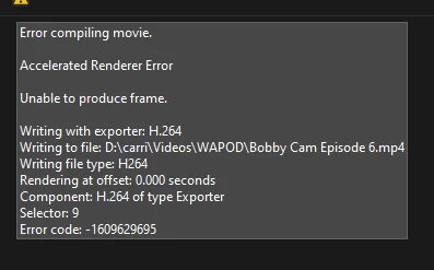

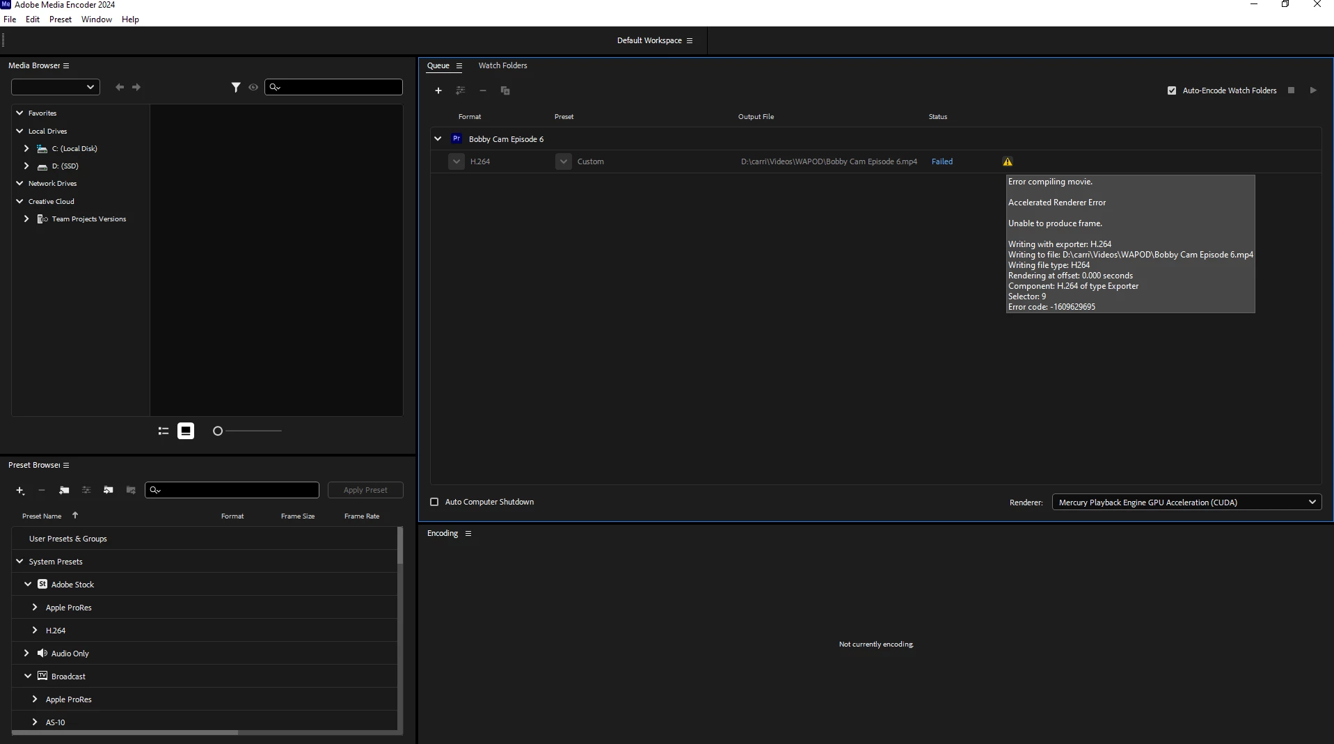

I export videos every week and haven't changed anything for the last few years and have never had this happen. The encoding starts up fine but after a short amount of time it just stops. When I remove the file and try to export again, the encode fails (pic below)
(here's a closeup of the error text)

It worked! I had to follow every step of that link that you sent. My main concern now is whether or not I can go back to using my exporting presets that I've been using for the last 2 or 3 years. (might not be a huge issue unless there are notable quality losses)

Peru Bob
November 21, 2023
Try turning off Hardware encoding in the Video tab of the export settings.
