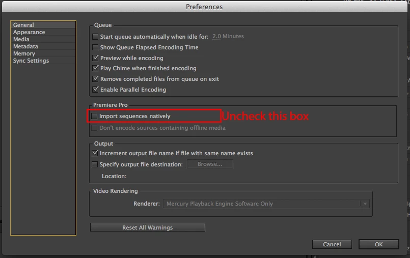

March 4, 2015
I managed to solve the problem by unchecking the Import sequences natively box. Now it works normally, I can queue to it and import Premiere projects into it.
I'm on Macintosh OS X 10.8.5
