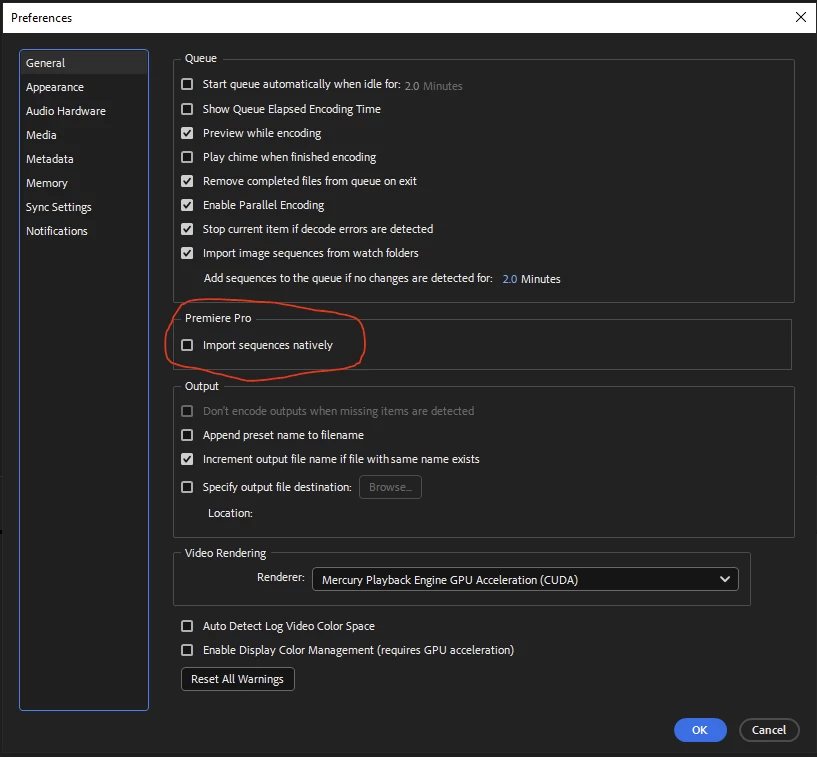

I believe I have solved my problem -- for anyone else with the same issue
I went into system preferences on the mac - Privacy and Security--full disk access and turned it on for Premiere Pro and Media Encoder -- apparently one of the updates may have turned it off?

Oct 27, 2023 2:21 PM UTC
Bless you TalaAll! that fix worked -- wish I had seen this yesterday
Sep 27, 2023 3:21 AM UTC
Just an update.  Found the solution on YouTube.  In Media Encoder (I am using Media Encoder 2023) go to Edit > Preferences.  In the General Tab about half way down the acreen is "Import sequences natively".  You need to Uncheck this box.  When you send the video again to media encoder the errors will be gone!
