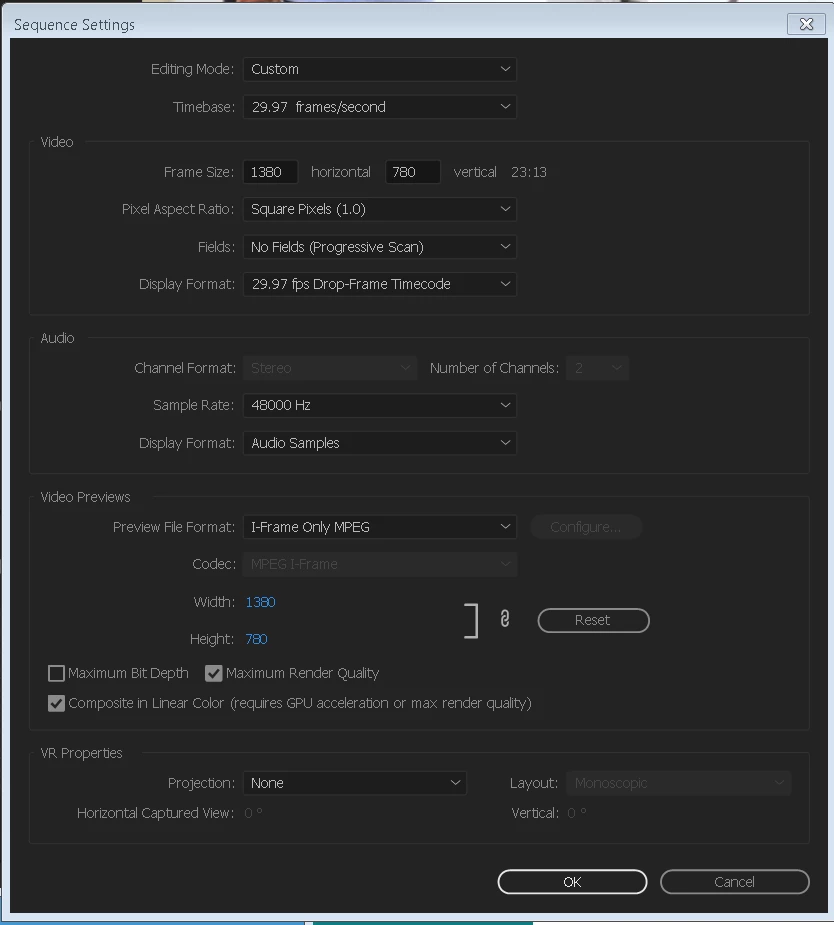

    Are you editing in a sequence set for the 1920x1080 frame size? Please post a screen shot of your Sequence settings, and post a screen shot of the Summary in the Export Settings Pane.
    If editing in a sequence set for the 1920x1080 frame size, you are enlarging the stock footage clips several magnitudes in size to get them to fit on the frame on that timeline - and that is revealing and exacerbating all the artifacts present in the stock footage.
    Not much you can do about that, if you want the 426x240 stock footage to fill frame.

    Here are my sequence settings:

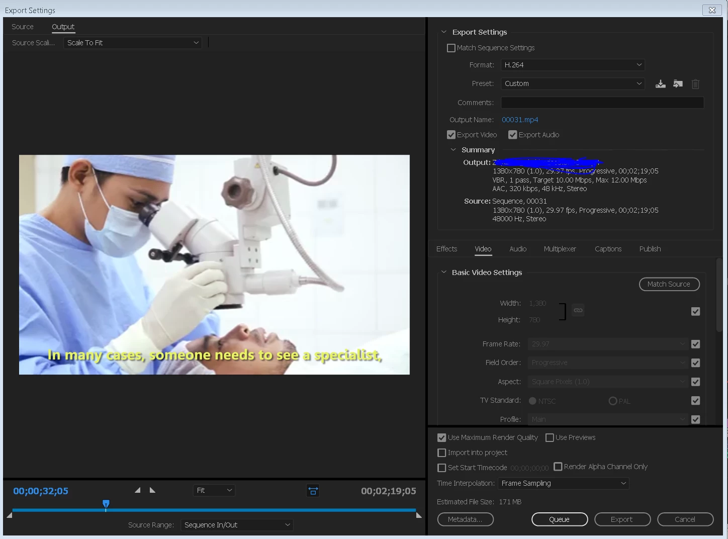

    Here are my export settings:

    If you want them to appear the way they looked when you download them then your sequence resolution must be 426x240, it's as simple as that. You can scale footage some and get away with it, but again, it depends on your delivery method. There are many other factors that will go into this as well, such as, if you're uploading it to YouTube the file will be accepted, but it's going to be shown on a larger player, which means that YouTube is effectively scaling up your footage and it won't look good.

    You actually answered your own question. The resolution of the stock footage is incredibly low, 426x240. You're then blowing that up to 1920x1080. To look at it another way, 1920x1080 is just over 2 megapixels and your stock footage is just over .1 megapixels. There's no getting around this, you have super low res footage and you're blowing it up. There are plug-ins to up rez footage, and After Effects can do a pretty good job of it, but this is an extreme case—nothing you do will be able to improve the quality of this footage.
    The reason you say the footage looks worse than it did when you downloaded it is because you were looking at the clip at 100% of its size when you bought it as stock, i.e. it was really small, so it looked fine. Now that you blew it up by 450% and you're exporting the 1080 version you're seeing the big issue.
