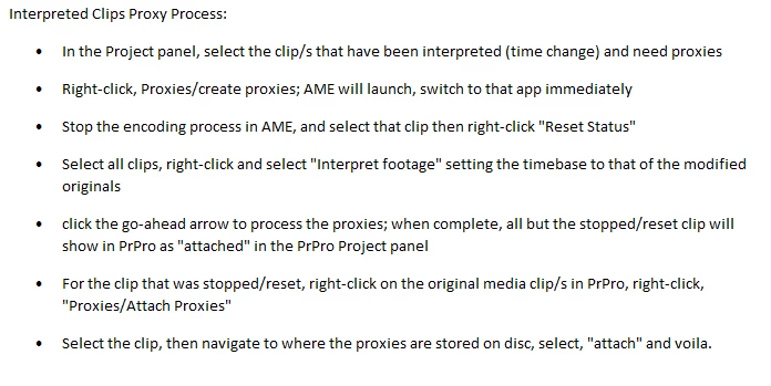

R Neil Haugen
March 13, 2020
Premiere's proxy routine is a bit odd in places. Such as the limitations is has on interpreted time media, like yours. Technically, it's not a bug, it's the way it was designed. I've had several long discussions with engineers at NAB over this. They've got internal reasons of course ... but as a user, those don't ... "fly" too well.
It doesn't do what we expect or want it to do for time-shifted media.
There's been several workarounds 'published' over time. Like this ...
But it would be nice if they'd just get the proxies to play matching how the original clip is set.
Neil
Everyone's mileage always varies ...
