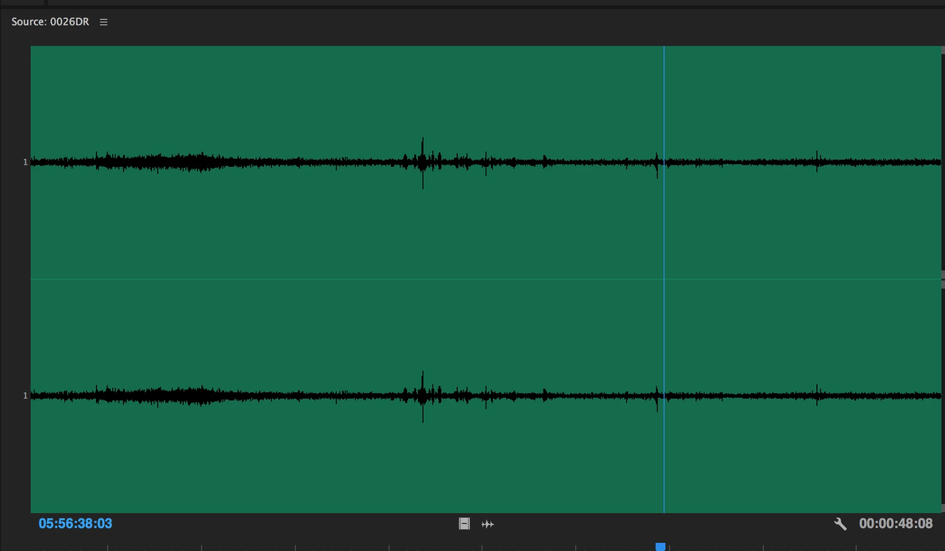

Original:

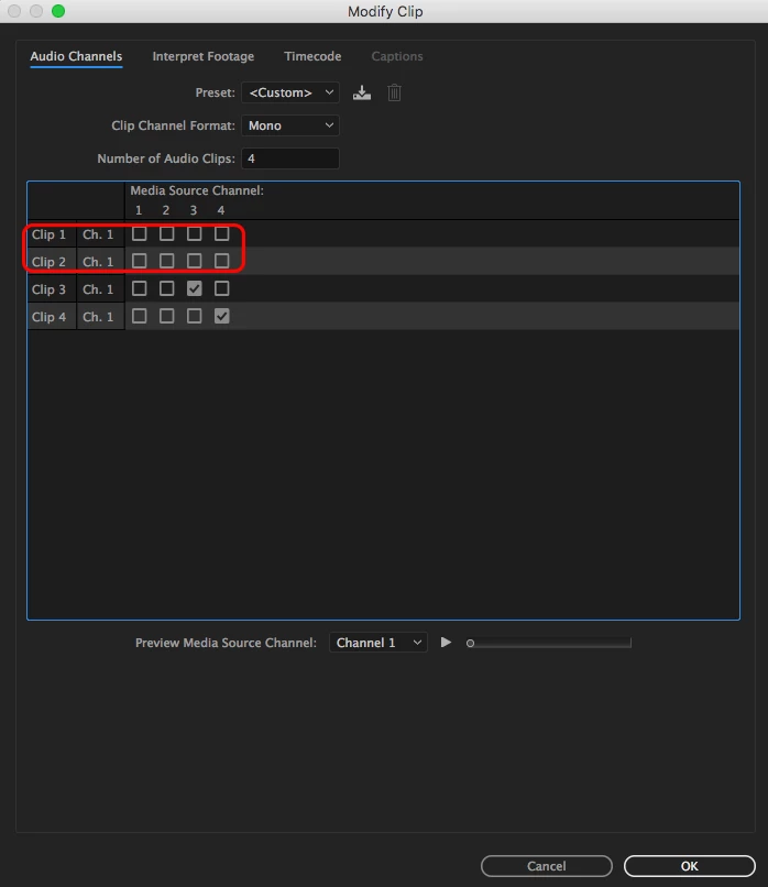

Want to remove the ones in red:

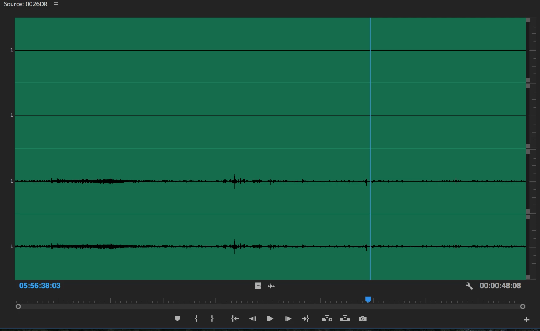

If unchecked, unwanted audio will not show up in Source Monitor when load clip:
But will insert blank audio clips into sequence (in this case, the unwanted clips were blank, but inserts blank even if unchecked clip has audio):

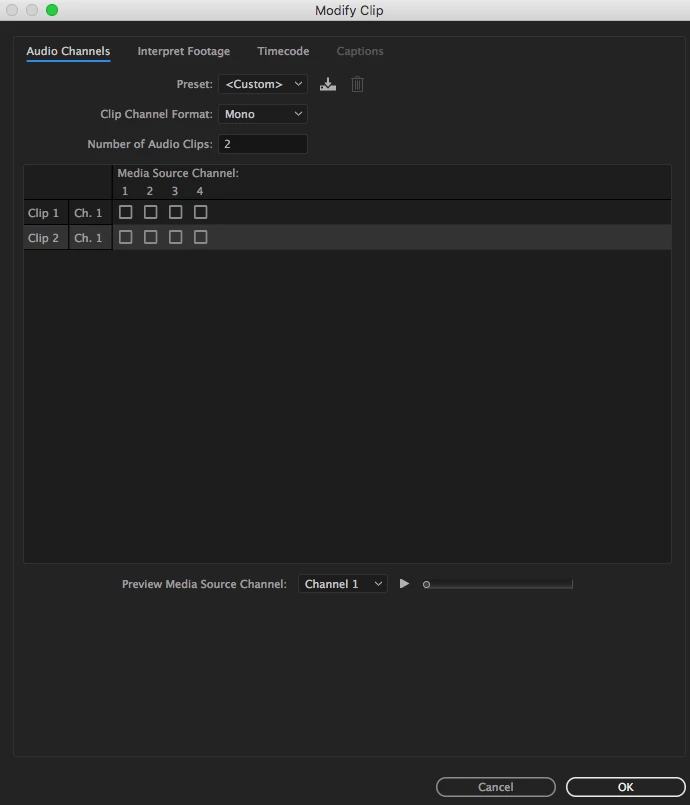

With 2 Audio Clips, 1 & 2 always remain:

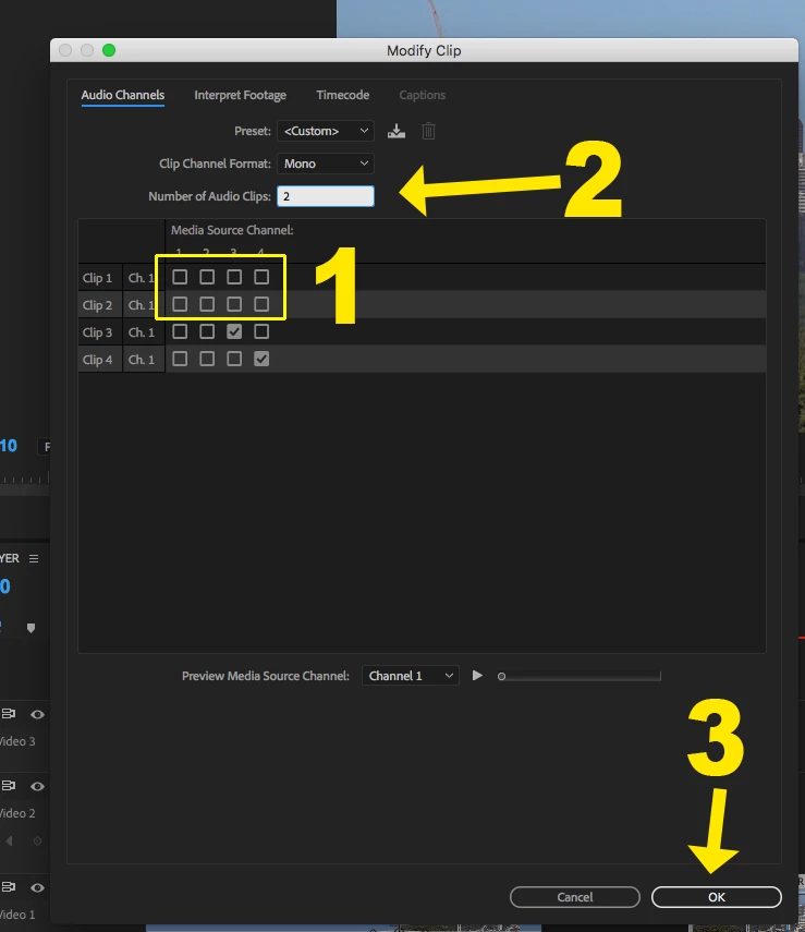

Try:
Uncheck Tracks 1 & 2
Switch the number of Audio Clips to 2
Press OK
Test and check the results.
MtD

Thanks Meg, I already addressed this in my original post. When you switch number of Audio clips to 2, the clips that will remain will always be 1 & 2 whether or not they are checked.
