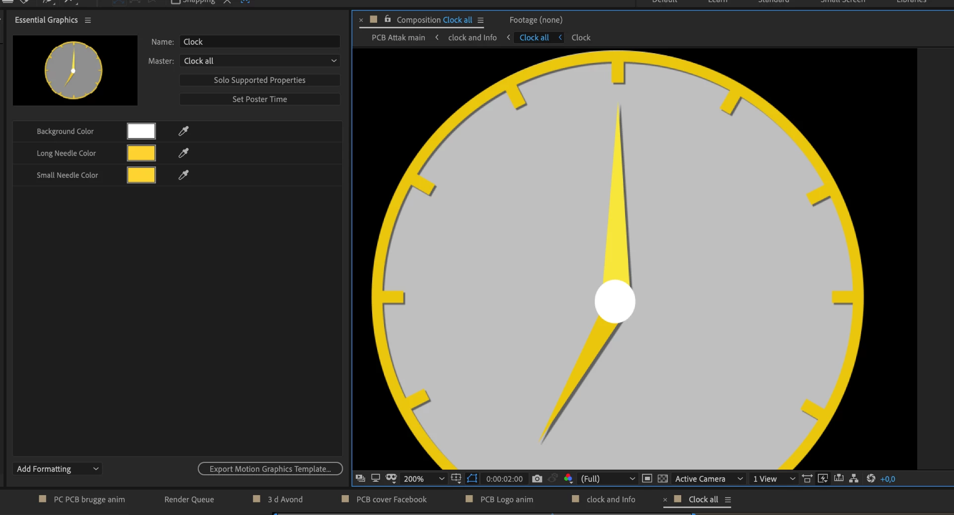

I was wondering key framing a MOGRT in Premiere is possible.
I made a clock and would like to rotate the needles (like I would do in AE).
So far, I do in AE via dyn link.
Thanks for you help,
-J
Correct answer Ann Bens
Build this animated analog clock in After Effects and export a MOGRT for Premiere Pro - YouTube
At the end he tells you how to set the time to use in Pr.

Thank you - I did not think of trying that. HAve

If you use Pr Graphics (Graphics that come from mogrts you make in Pr) then you get all the effects and keyframes when it is applied in Pr. But for Ae Graphics (Graphics that come from mogrts you make in Ae) you only get what was added to the EGP in Ae. Keyframes are not yet supported properties there.

Ok - really good to know. So far I have only made MOGRT from AE. cuz I am more comfortable with AE graphics, I will try to do it via Pr. Thanks for the suggestion.

I have been researching further, it does not seem to be possible.
so far I have been doing manually each hour I needed, but I am still hoping to find a solution.
if anyone think of something, pls let me know.
