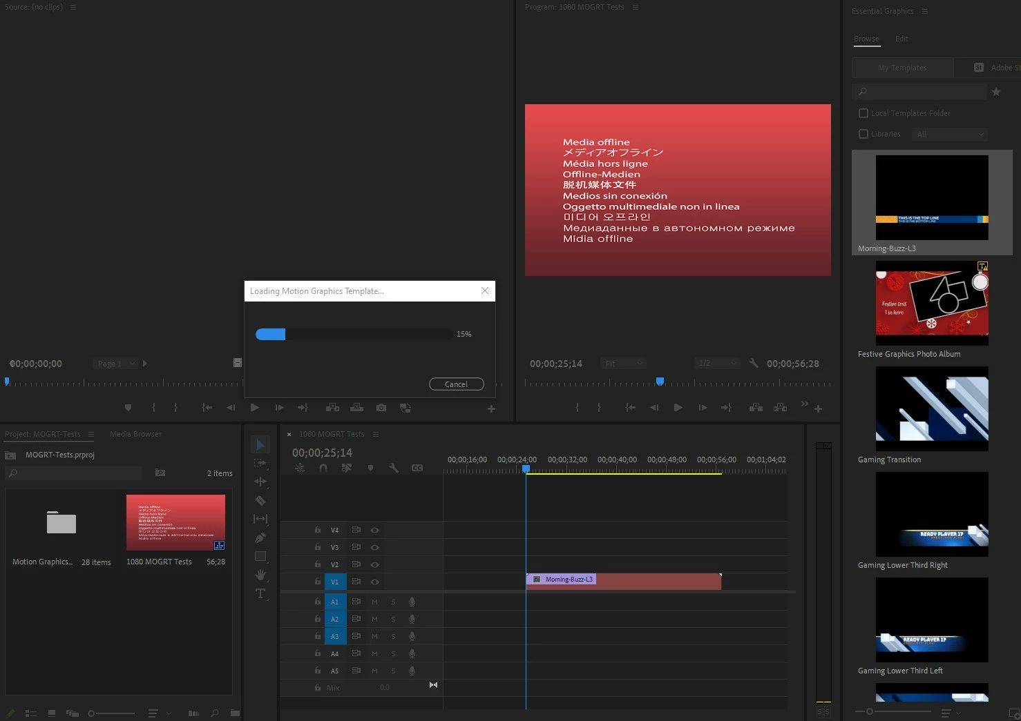

Hi. I'm working in Adobe Premiere v23.6 on a Windows machine and MOGRTs from the Essential Graphics panel won't load anymore. They all get stuck at 15% regardless of whether they're the stock ones that come pre-installed with Premiere, or ones I built myself in After Effects. After some reserach, I found this was a problem several years ago, but I can't find any fixes for the most recent version of Premiere. Any suggestions?

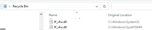

August 30, 2023
I deleted the 2 ff_vfw.dll codecs I found. The low-level GetAVICodec error message went away, but mogrts will won't load into timeline.

Thanks for the additional info. I don't think unplugging the webcam is enough. The issue is in whatever Logitech Codec is installed + 23.6 having a conflict 😞
If this works on your system in 22.6 and not 23.6 with the same codecs installed then surely there is a bug here. But it would be great to confirm if your mogrts get back to functional in 23.6 without that codec. In the meantime, I'll see if I can get my system in a similar state to reproduce the error.

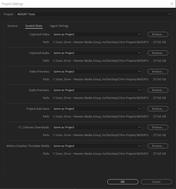

Scratch disc setting attached.
I will have to get IT involved to ask about drivers and Logitech cameras. I do have a Logitech webcam attached, but as far as I know, it was plug-and-play - no driver necessary. However, I unplugged the webcam today to see if it made any difference, and I still got the same errors.

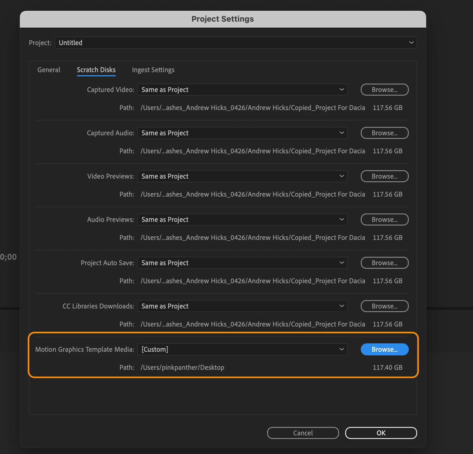

The scratch disk settings I'm asking for are in your Project Settings and look something like this: (this is the Mac version)
Windows OS has a very frustrating limitation of 250 characters per file path. The Mogrt cannot be unzipped to be used in the project if the Mogrt scratch disk folder is nested in a series of folders that would push the unzipped mogrt file path to more than 250 characters.
