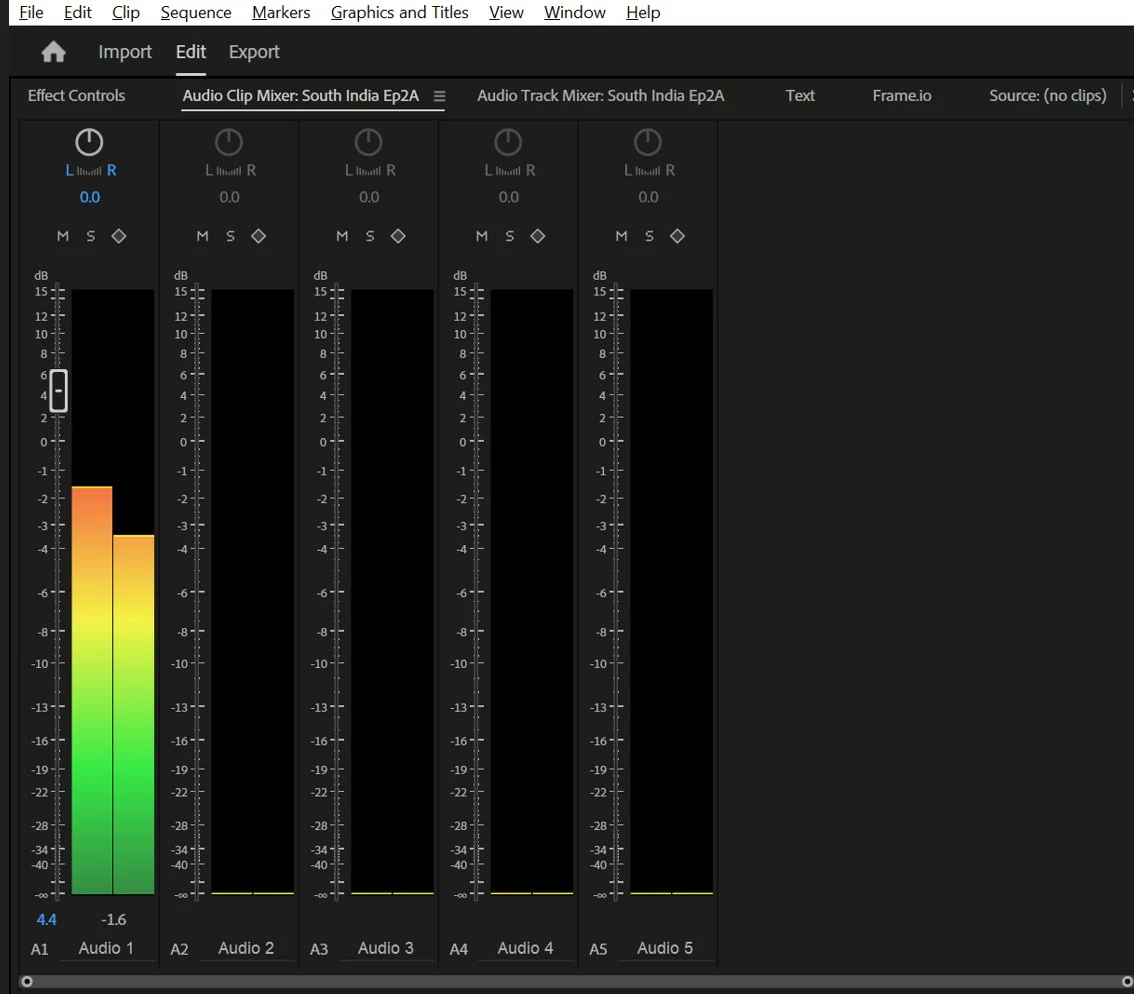

Are you sure you are using Clip Mixer Tab and not Track Mixer tab.
Track mixer will affect all clips.
Select clip tab if you need to adjust for a specific music file.
To adjust an entire track use the Track Tab
See attached screen shot

Jan 9, 2026 6:57 AM UTC
You can’t adjust audio faders with the mouse scroll wheel in Premiere Pro.
The easiest way to make fine audio adjustments is in the Timeline:
  • Select the clip.
  • Press [ or ] to decrease or increase volume by 1 dB.
  • Hold Shift while pressing [ or ] to adjust by 6 dB.
You can change the large adjustment amount by going to Preferences > Audio and modifying the Large Audio Adjustment value.
