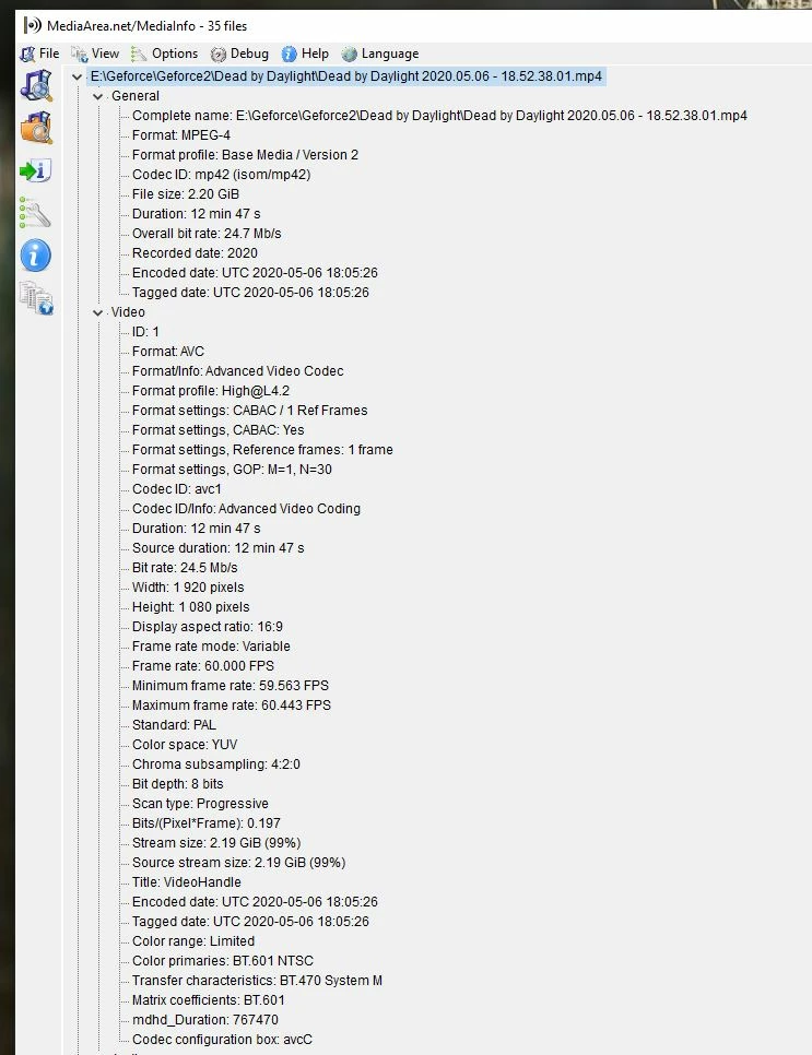

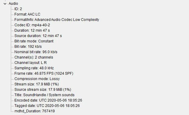

Please use the free MediaInfo and post a screenshot the properties of your media in tree view:
https://mediaarea.net/en/MediaInfo
May 19, 2020
here we go... Thanks..
May 19, 2020
There it is! It's variable frame rate footage!
See my suggestion above about creating a CFR version with Media Encoder or Handbrake. ProRes/DNx/Cineform would be preferred if you have the storage for it as it will be smoother editing for you.

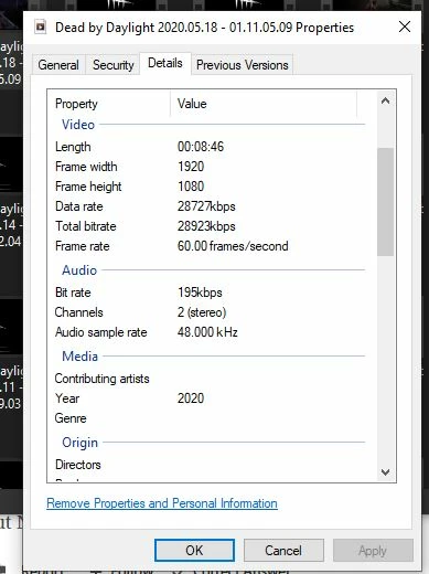

May 19, 2020
I just got a properties screen grab of one of the PC captured clips..
May 19, 2020
Hard to tell if it's VFR or not with that screenshot. It could have an average variable frame rate of 60.00fps, or it could truly be 60fps CFR.
As Peru Bob mentions, MediaInfo is a great source, or I should have specified: Right Click > Properties in Premiere. Again, it may not be VFR, but this is a common topic so it gets brought up a lot in Premiere circles. This is why another suggestion I often make is to transcode to ProRes just to see if it works out any better than the H.264 decoder.
However if it's fallen out of sync at the capture level and has been written to the file that way, you may simply have to edit it at some points to get it back in sync.
