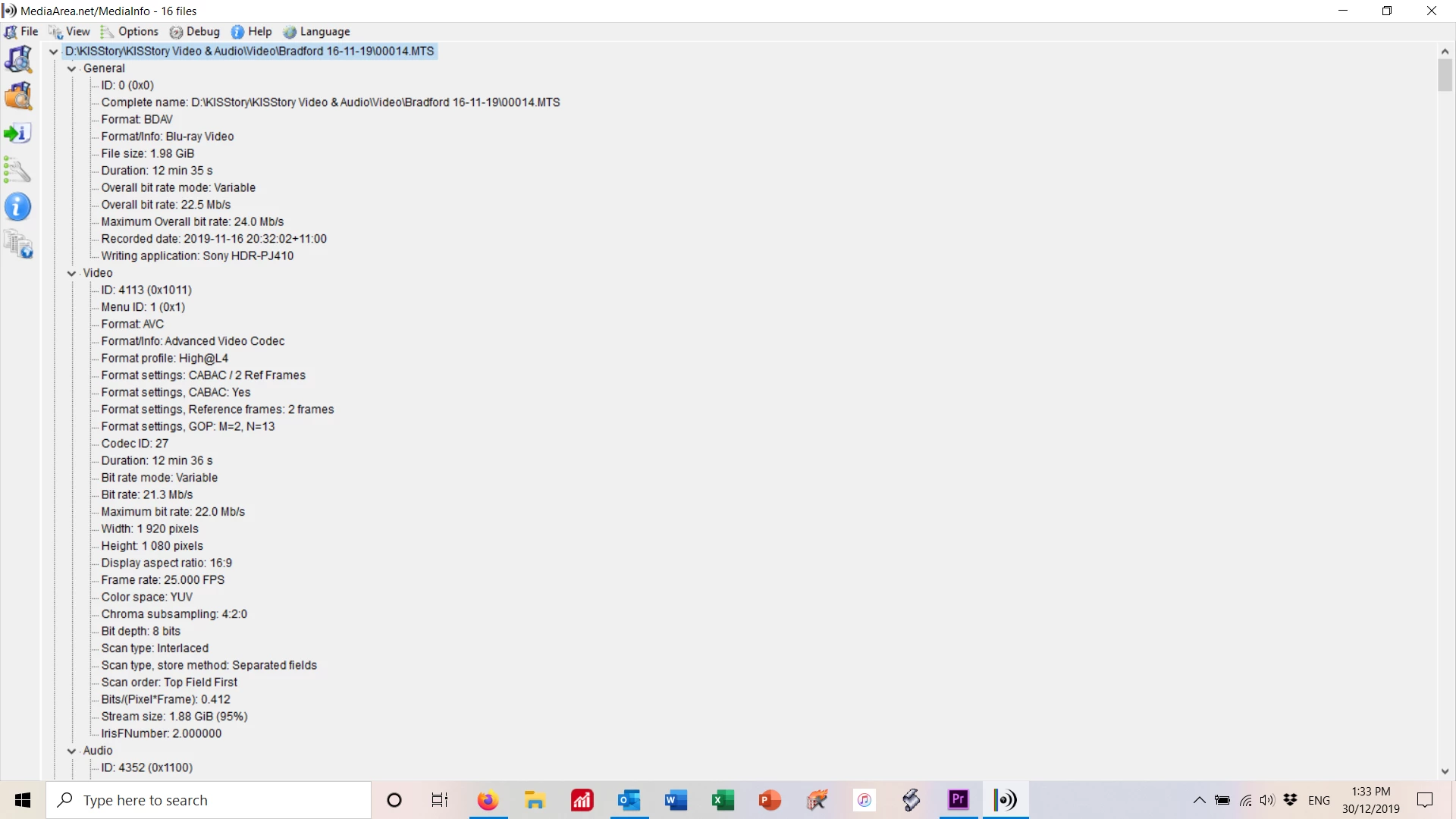

You can get the free MediaInfo program here:https://mediaarea.net/en/MediaInfo
Open a file that goes out of sync and post the TREE view info

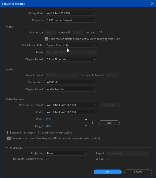

Regular cameras don't produce variable framerate.
Make sure the timeline matches the footage as it is interlaced.

Is your media variable frame rate?
December 29, 2019
My version is 14.0 Build 572.  Not sure if media is variable rate, they are .MTS files.  Never had an issue before with older versions.
