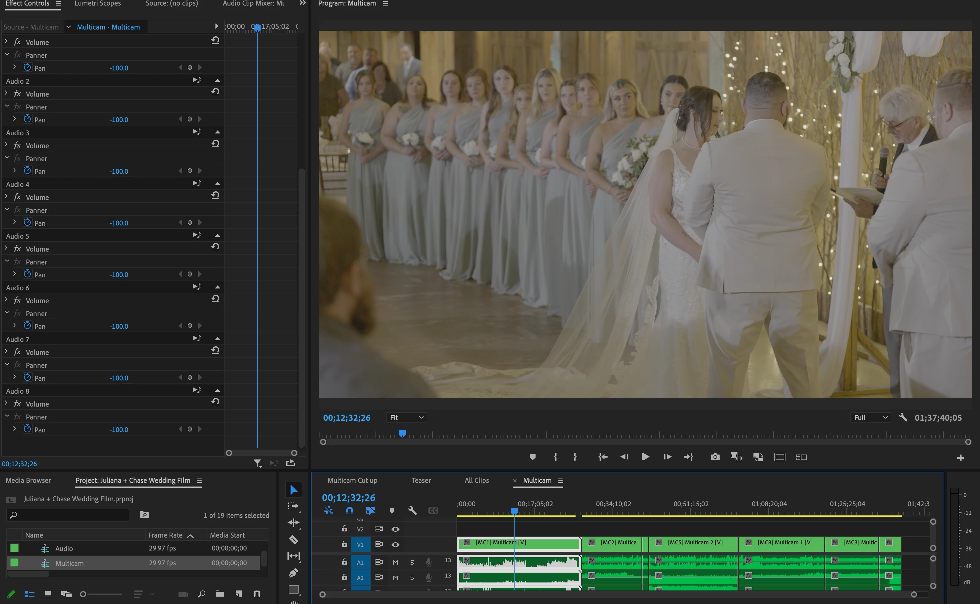

September 28, 2023
My issue is that Premiere automatically pans all of the tracks to the left when I create a multicam sequence.  The solution is to just go one by one panning them all back to zero.  It's super annoying and time consuming doing this because I will have 15+ tracks on a multicam sequence and I will have sometimes 10+ difference multicam sequences from the day during a wedding or a concert.  This sometimes takes me 30+ minutes just to pan everything back to zero.  Adobe needs to just fix this so everything pans to zero automatically.  I can't believe there is no setting to fix this.  Its such a waste of time for editors.

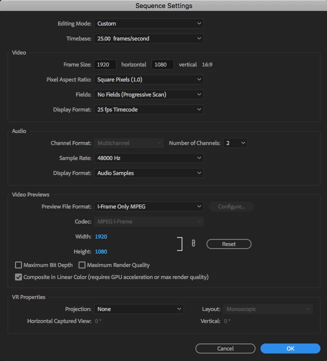

Mark Vandenberg
March 28, 2022
Going into the sequence settings and changing the number of channels from 1 to 2 under Audio.

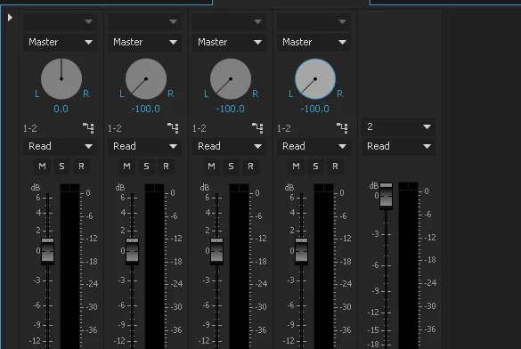

December 1, 2020
Forgot to mention I am using Adobe Premiere Pro 2020 from Adobe CC.
September 17, 2019
I have experienced the same problem.  That is, mono tracks only heard on left side.  The fix for me was to view the audio clip mixer where the audio tracks defaulted to "-100" in the L/R balance which forces the sound only to the left.  I changed it to "0" which centered the sound and solved the problem.

June 15, 2018
I fixed it by going to dropdown menu: Sequence/Sequence Settings... and changing the number of channels to 2.
