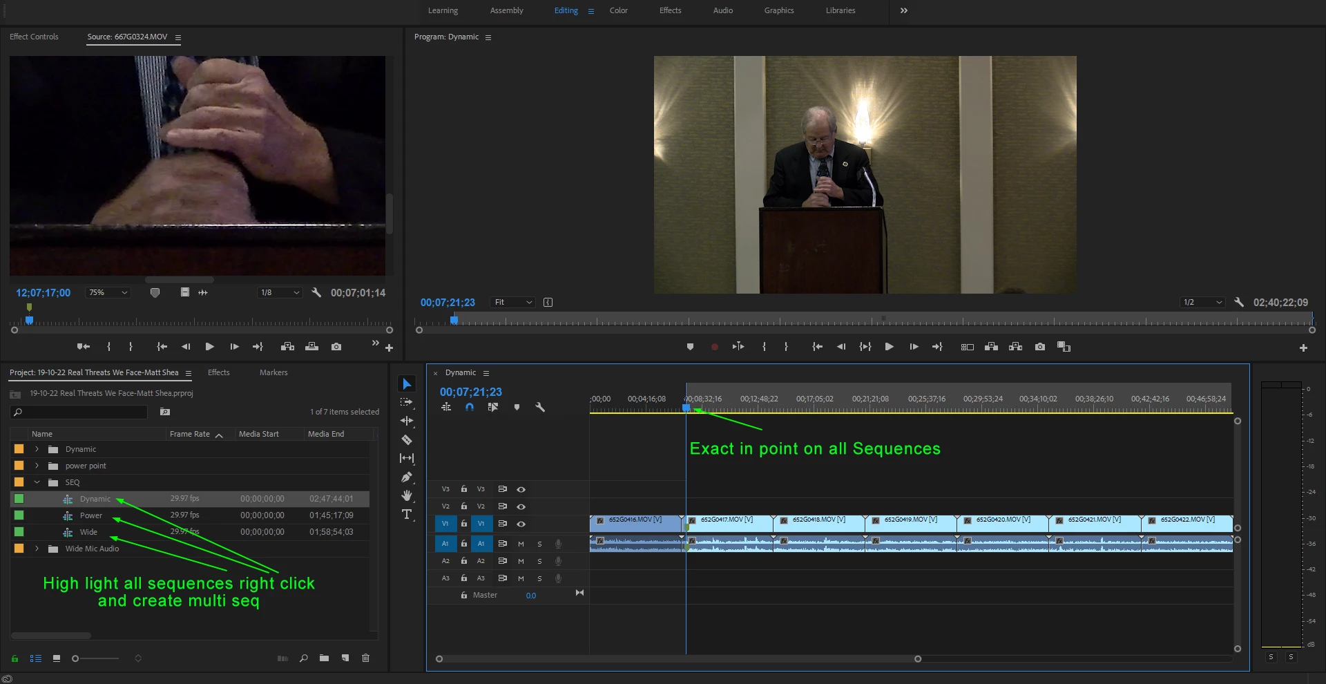

1) I put all the clips one after another in a sequence.
2) I then did this for camera 2 and camera 3.
3) All sequences have the same in points. I
4) then highlighted all sequences and right click to make a multi sequence.
Result is at no point in the new sequence are all camera in sync. What am I doing wrong?

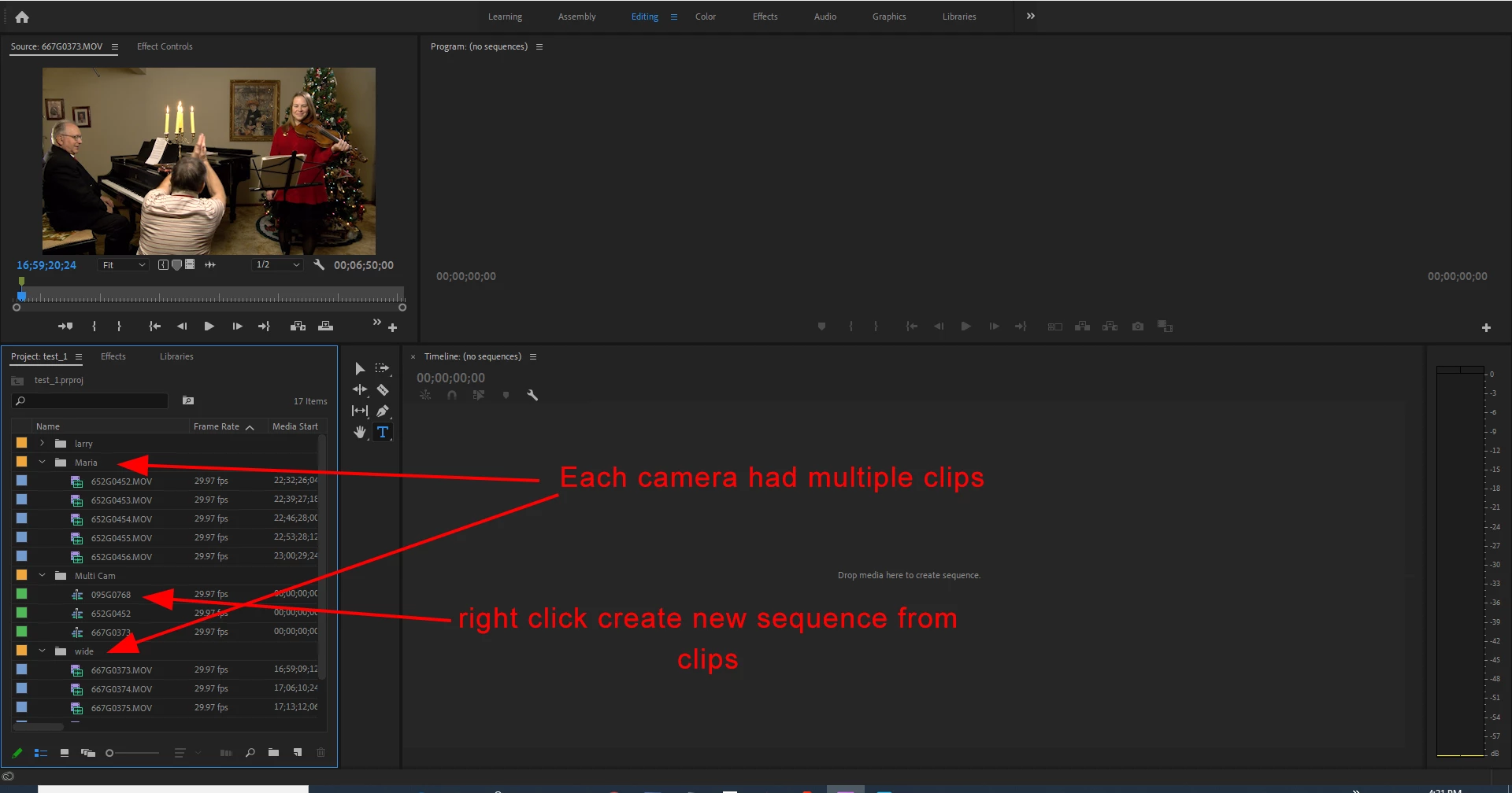

    "I take it you have a bin that has all the clips from a shoot in it." NO,  I have a seperate bin for each camera, each camera's bin has multiple clips in it.
    Here is the work flow that works:
    1. Grab all cliips in bin for that camera
    2. righ click and create new sequence
    3. Go to begining of each seq and trim to clap in time
    4. Move the seq to begining of timeline and delete black space.
    5. Move all sequeces into single bin
    6. Create a multi camera sync
      Click on this link and it will go full screen. There you will see my setup.
      https://community.adobe.com/t5/image/serverpage/image-id/49093iAD11F1F61BA690C5/image-dimensions/2500?v=1.0&px=-1

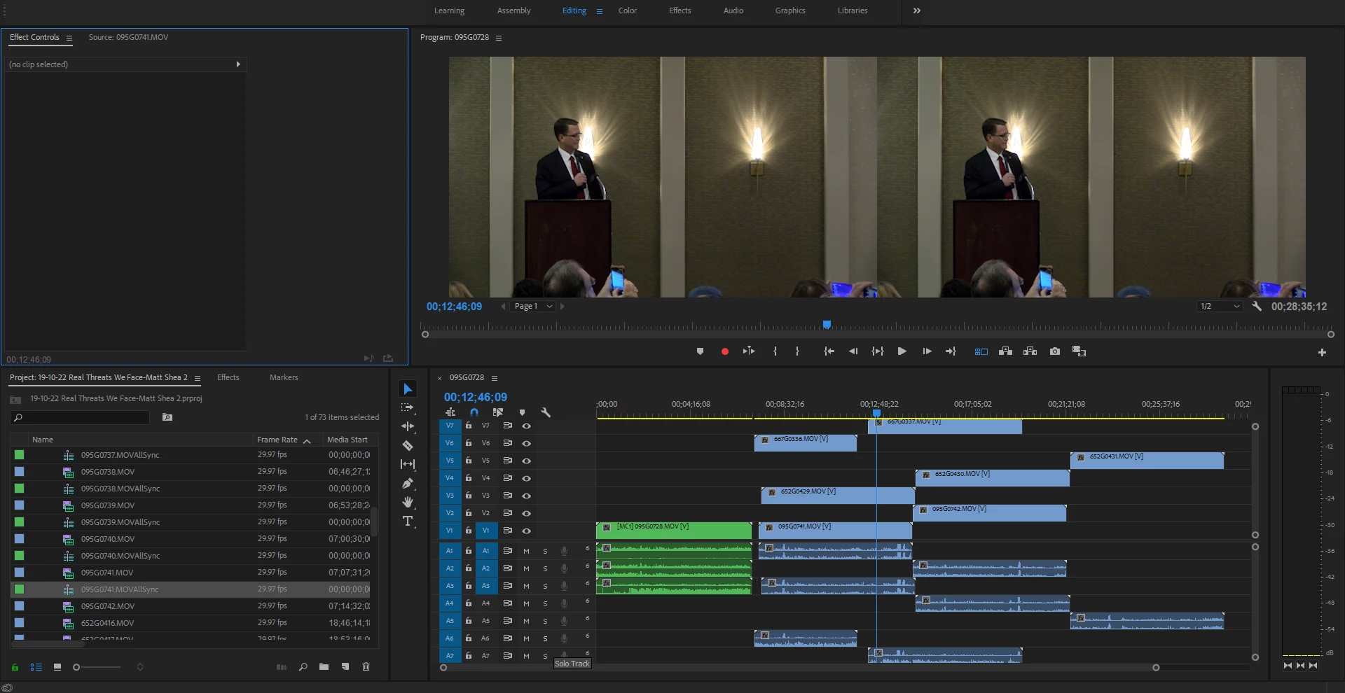

    Keep in mind we are talking about multiple clips per camera and multiple cameras in use. refer to this picture.

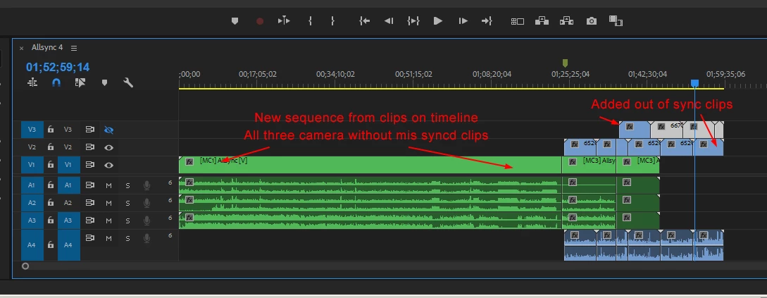

    Working now with making a new sequence from all the clips on the timeline. This makes one long clip. (I took out all the ending clips that were out of sync where the battery ran out. However the in points are still not lining up but the audio sync seems to be working.
    4. Create a multi-camera target sequence
    Edit the multi-camera source sequence in a target sequence.
    To create a target sequence, with the multi-camera source sequence selected in the Project panel, choose File > New > Sequence From Clip. You can also right-click (Windows) or Ctrl-click (Mac OS) on the multi-camera source sequence and select New Sequence From Clip from the context menu.
    https://helpx.adobe.com/premiere-pro/using/create-multi-camera-source-sequence.html

    RonaldCz
    RonaldCzAuthorCorrect answer
    Oct 26, 2019 1:20 AM UTC
    Yes, new sequence from clip was the answer. It's makes a new sequence from all the clips so now you can do an in point (which did not sync for me) or do an audio sync (which did work).
