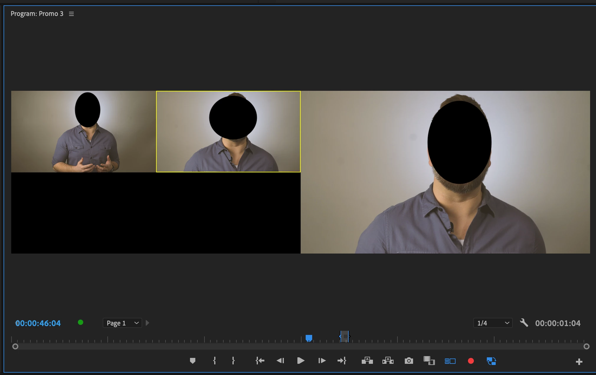

thank you for the reply. The reason I merged them was to sync the sound, perhaps I should just sync and then create a duplicate of the video file?
Here is the screenshot your requested to clarify my intentions. Bascially to punch in on the same shot to create a cut for the interview.
Thanks
February 20, 2020
I put the 4k files in a 1920x1080 sequence (which is how I will export the video) so I can see how the scaling will look whne exported. When I scale with the GoPro proxies, the frame is a different isize and cannot see how it will look.
