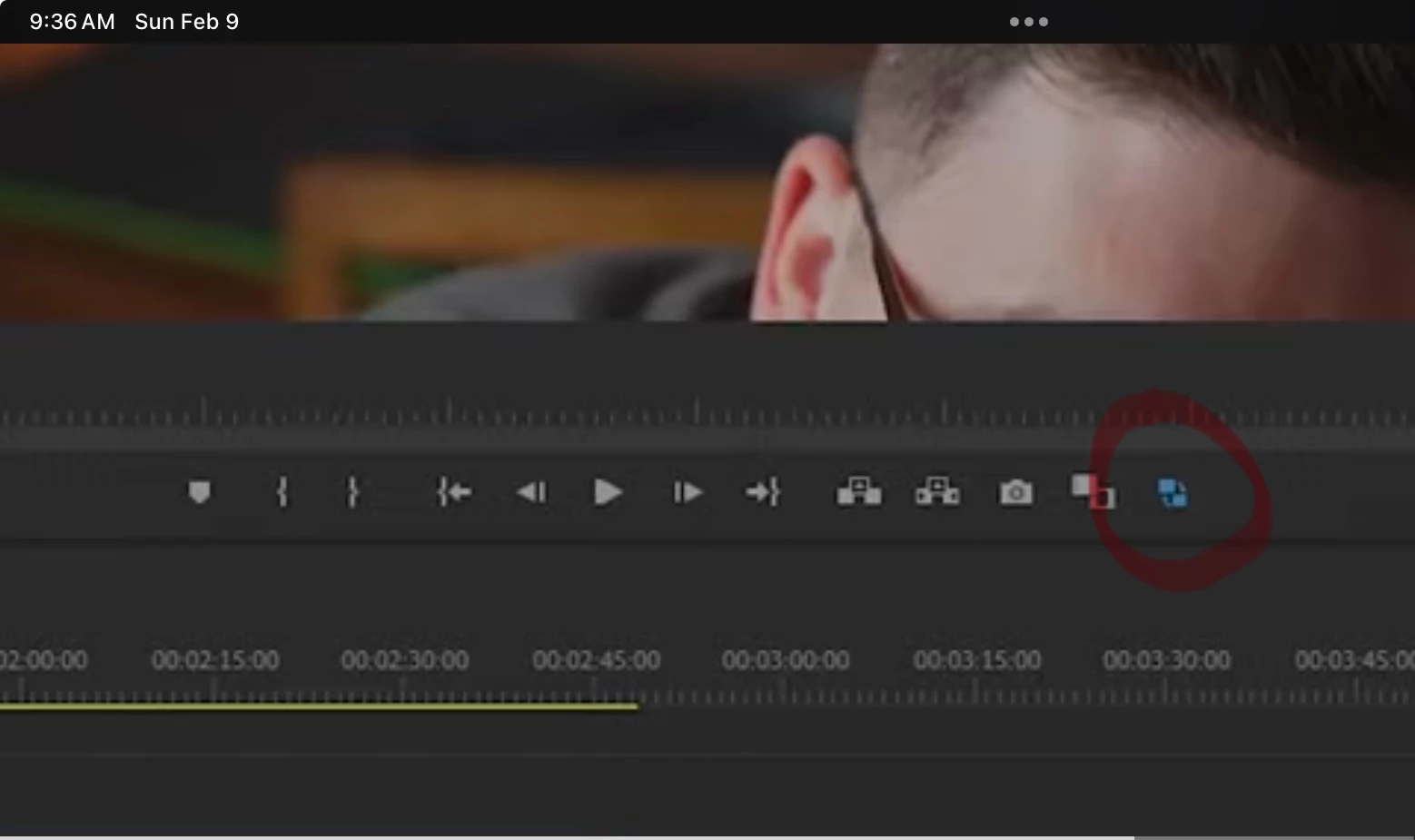

I also see that sometimes in YouTube videos I see the proxies toggle button is blue when on? My tests do not have this so wondering if that has to enabled or I am doing something wrong when I did my test project?

Thank you, I am creating the proxies first and will use that workflow. On the second question I have the watermark turned on and it appears all is good when I toggle between proxies and not using them. I just saw many videos where the toggle button was blue when active (see attached)mine is just grey like normal and a line though the icon when off. Was just curious if this changed or something?

The blue buttons are from an older version of Premiere. They've recently made some changes to the appearance, one of them being the implementation of a light and dark grey theme, so there are no more blue highlights or button colours.
