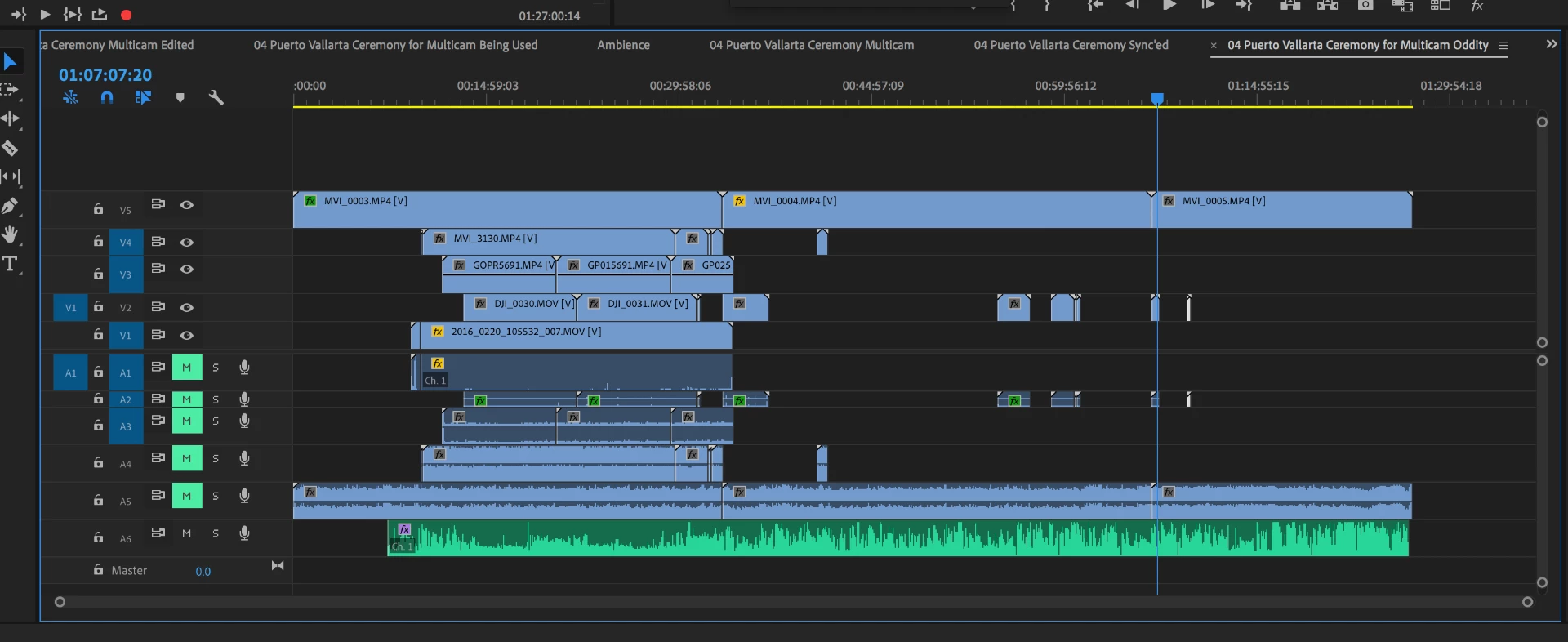

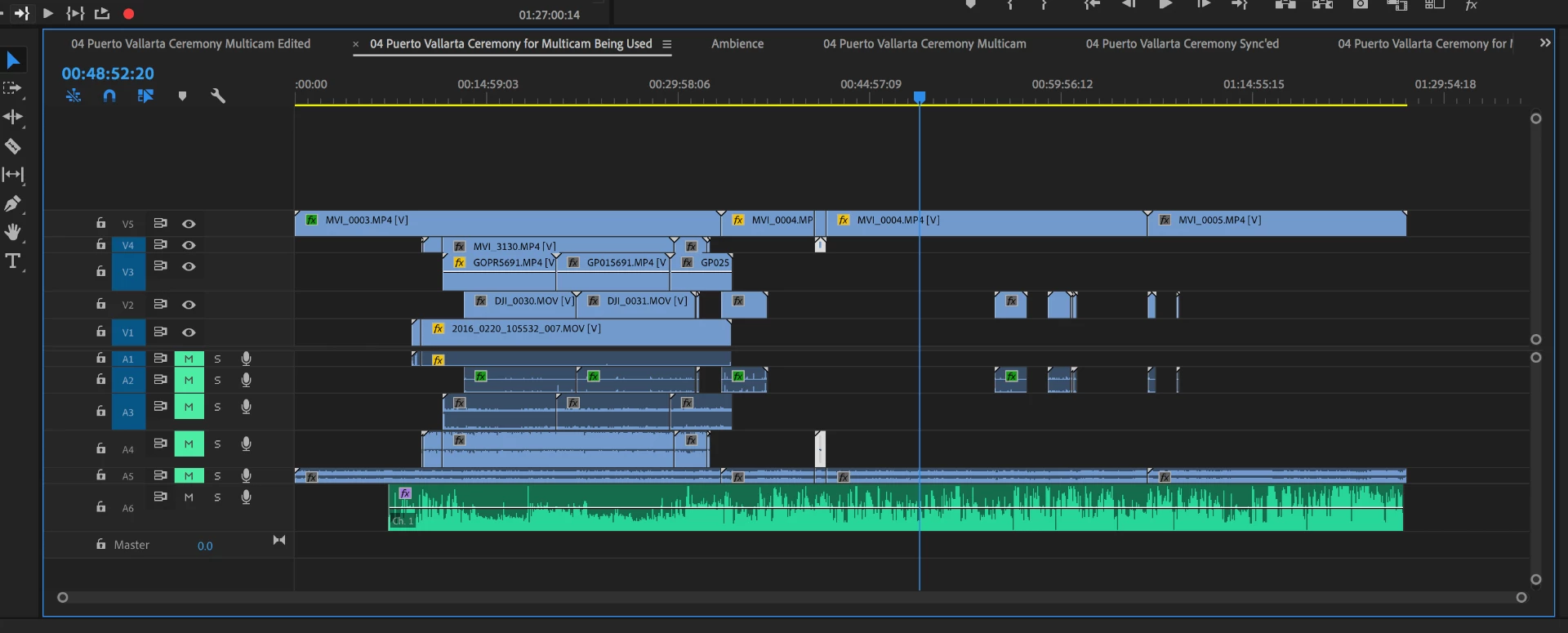

    Can you post screenshots of your multi-clip and your editing sequence? It sounds like your tracks inside your multi-clip aren't targeted, though. Make sure all of your A1, A2, V1, V2, etc are targeted (big blue box on on in the track header) for them to show up in a MC sequence.
    October 26, 2018
    I'm not sure if the targeting has anything to do with it, as I haven't changed any targeting and it is now working. I renamed the two sequences ("Ceremony for Multicam Being Used" and "Ceremony for Multicam Oddity"). When I'm in the multicam sequence and double click, it takes me to the "Being Used" sequence, which I had been doing all along while working on the project until running across this problem. When I turned on the audio track in the "Being Used" sequence, I could hear it but not see it in the multicam sequence, no matter which track I had the video placed on. But when I made the same change to the sequence now marked as "Oddity," it worked in the multicam sequence. Go figure.
    October 26, 2018
    When you say you double-click the sequence and you're taken to it, do you mean the multi-clip sequence opens up in the timeline or it opens up in the Source monitor? Also, just to be clear, the only difference in the two images is that the bottom one has two tracks patched, not targeted. I just want to make sure that we're talking about the same thing. In both screenshots V2 isn't targeted. Interesting that it now works, though.
