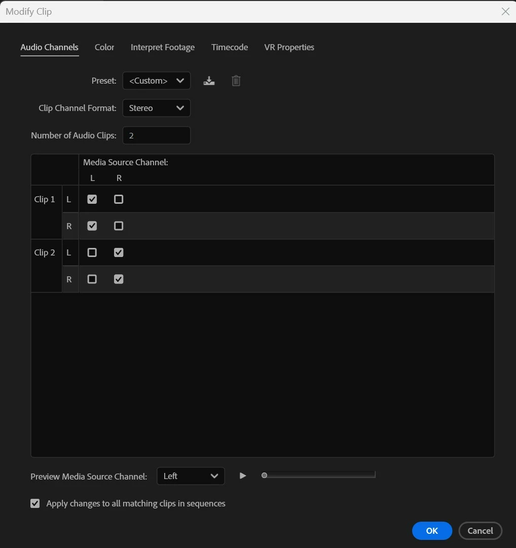

Also, I need Cam 1’s stereo audio split into two mono tracks: one for music (left) and one for tap audio (right). I used Modify > Audio Channels to separate them before building the multicam, but Premiere keeps duplicating both channels into both tracks.

Firstly the audio to split CAM1 tracks
You say
quote
When you do Clip(s) select, Modify Audio, don't forget to select 2 No. Clips. This creates two separate tracks then you can map Left or Right to either Audio track so you can split out your audio as you want, check audio mapping in Multicam project.
Use Track Mixer or Audio Clip Mixer to balance your audio mix
See attached Image.

Thank you for responding.  The audio was never an issue.  Been doing it for years.  I don't know if you saw my last response.  It's all been taken care of.  I made a new project and new prores proxies and don't have any issues.  It had to be something within the old project and proxies not working as they should.  I had redone the proxies in so many formats within the project that something definatley could have gone wriong behind the scenes.  Like i said...Once I made the new project and new proxies, everything i mentioned went away.
