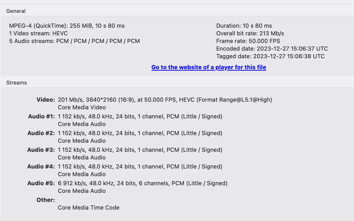

I synced my video files to audio for a mixer via Timecode in Tentacle Sync Studio.
It combines audio with passthrough video.
This way I get two audio streams with ten audio channels in total.
Four audio mono streams from my FX3 recorded internally and one with six channels from my mixer.
When I convert it to prores proxy with 10 mono streams it works.

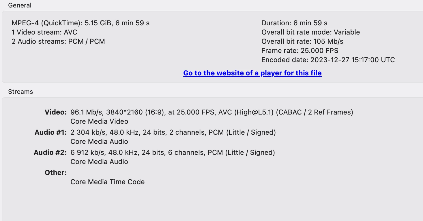

Then I try the ZV 1.
It has one stream with 2 channels - so a stereo-configuration.
With those six mixer tracks added its a total of eight.

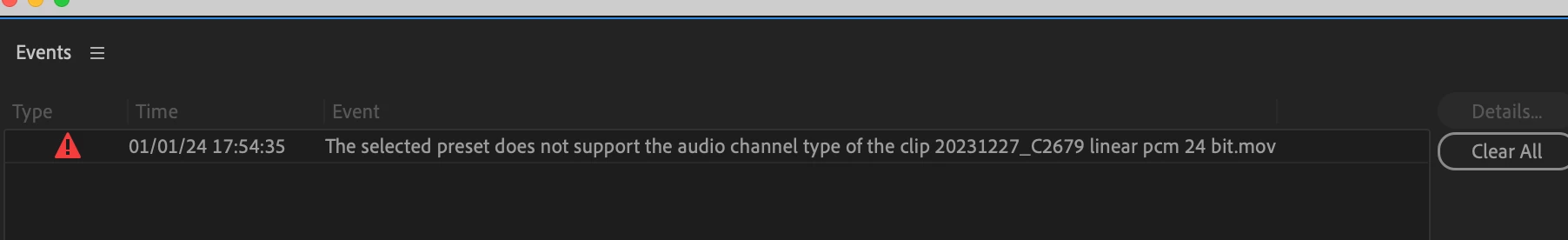

I cannot find a proxy setting that works, for example using eight mono tracks or four stereo gives me just the error message:
"the selected preset does not support the audio channel type"
Is there anything I can do?

Tried Prores Proxy Quicktime with all default settings and HD resolution as well. no luck.
