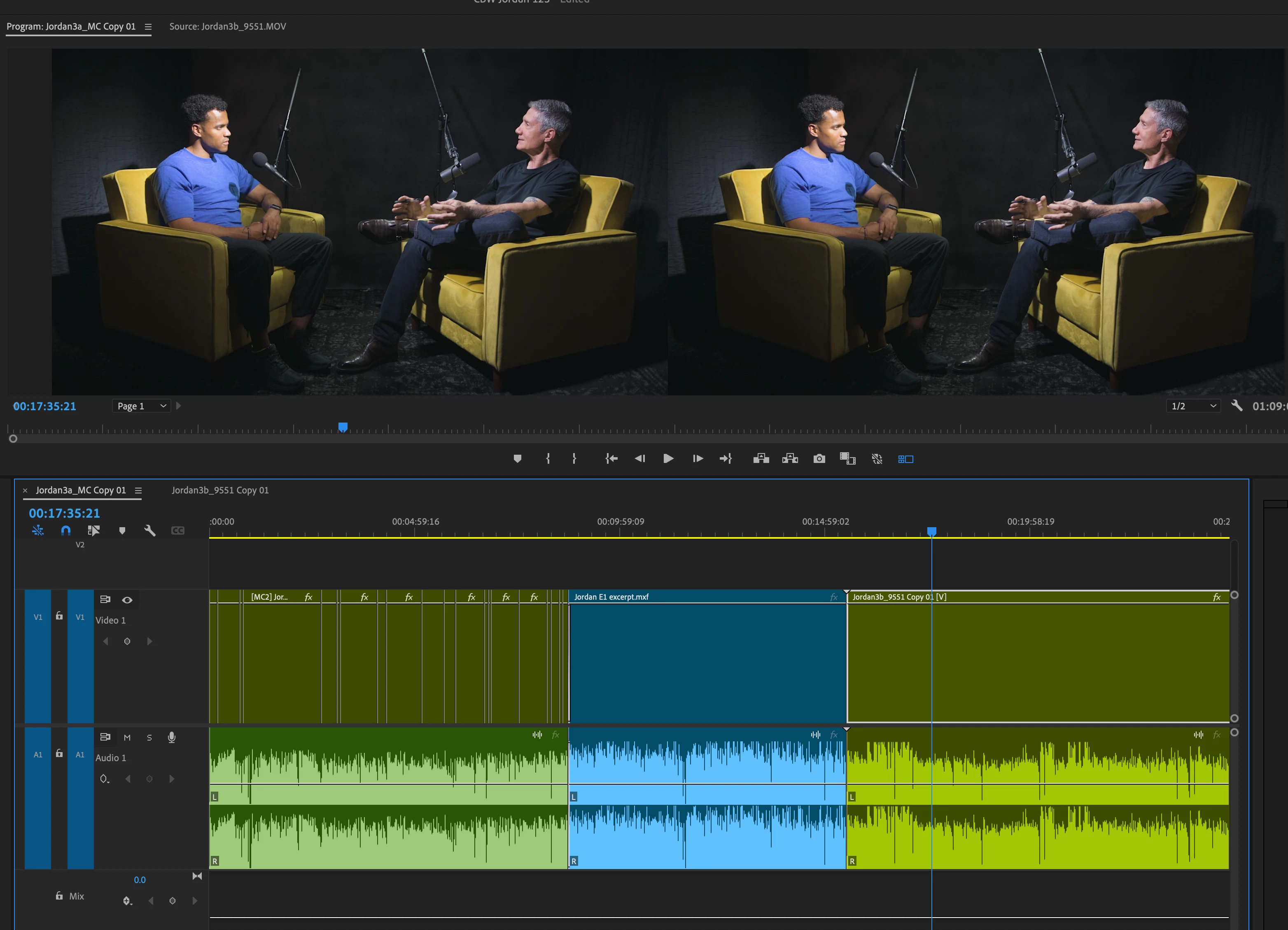

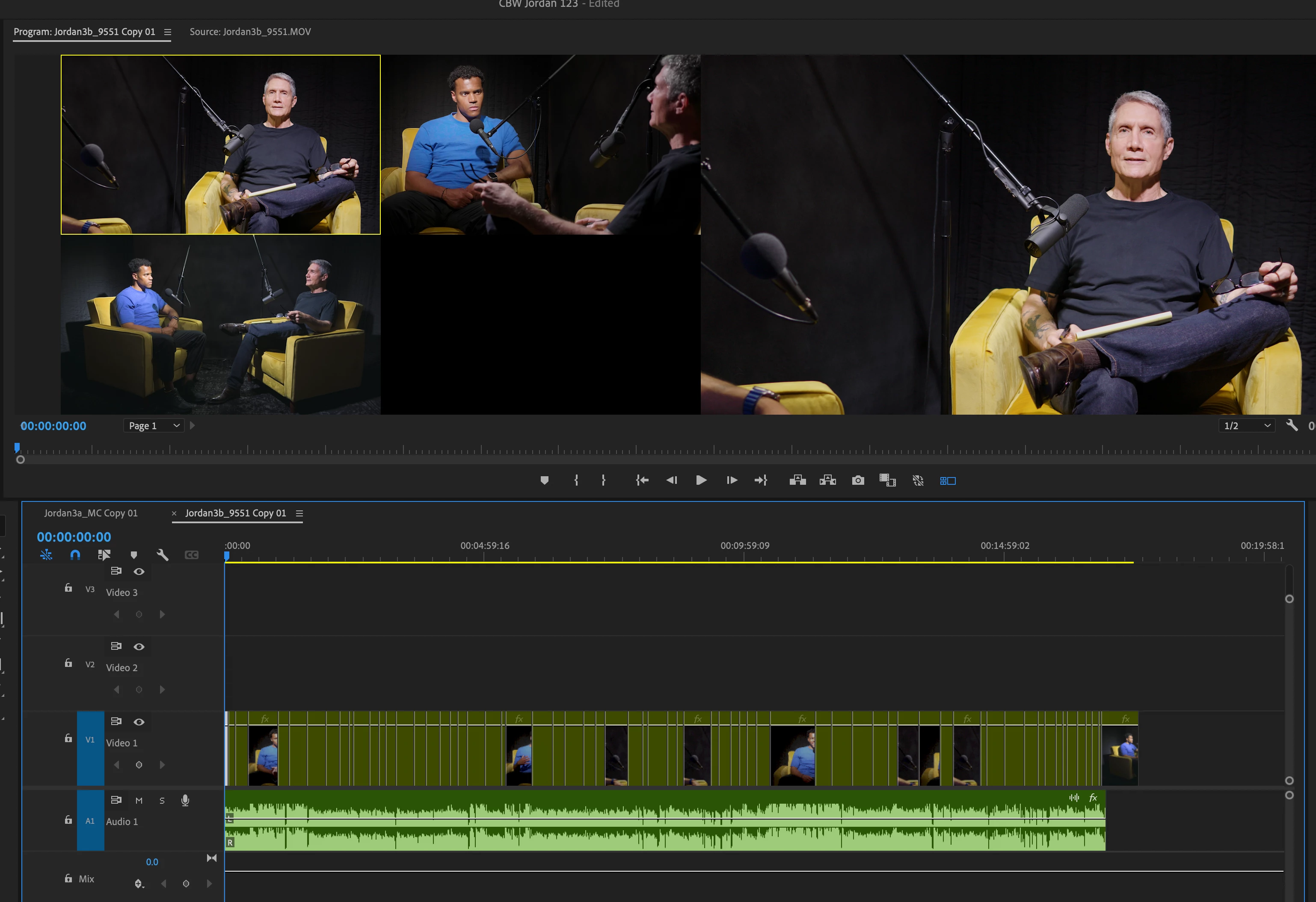

Thanks, Paul. First screen shot is the part 2 sequence on its own. Second shows it as added to the Part 1 sequence (plus "flashback" mxf.)
An additional note about the sequences: Part 1 had one unusable camera angle, so that track's visibility, in the expanded multicam source, was toggled off. Part two, all three angles are visible in the source. And to clarify, part 2 plays back as expected, but without discrete segments that can be further edited.
