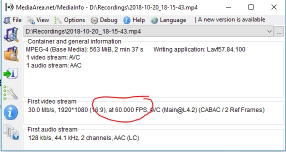

I record minecraft videos at 60fps.  Since the last version 12.1.2 and up, any video I record has a 3 in 4 chance of being imported into PP as 59.99fps instead of 60.  I keep having to revert the software to 12.1.1, where the bug doesn't happen.   This forces my video to be 30fps when I need it to be 60fps.
This really needs to get fixed.  Media info shows that the video is record at 60fps, but for some reason some files get imported incorrectly.
Here are images of what I see in PP and what I see from mediainfo...

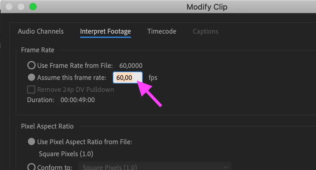

    Correct answer Byron Cortez
    You must interpret the Footage and set it to 60fps. Right clic / Modify... / Interpret Footage...
    Byron CortezCommunity ExpertCorrect answer
    October 22, 2018
    Byron.
    October 21, 2018
    In any case, are you not able to get around this by right-clicking the footage and then selecting "Modify > Interpret Footage" and then choosing "Assume this frame rate:" and enter 60.
    October 21, 2018
    Three words:
    Variable Frame Rate (also known as VFR).
    tinker77Author
    October 21, 2018
    @Rjl190365
    Four words:
    NOT Variable Frame Rate
    So guess again pal.
    Ann Bens
    October 21, 2018
    Please post the media info in treeview.
