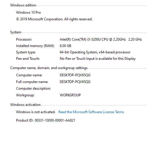

What are the complete computer specs, including hard drives (how many, what kind, what is on each, and how full)?
September 10, 2020
I hope this helps, I Tried sony vegas, and the playback worked so fine, it's just that I am not used to it, I don't think its my pc, i thinks its Premiere Pro
OS Name Microsoft Windows 10 Pro
Version 10.0.18363 Build 18363
Other OS Description Not Available
OS Manufacturer Microsoft Corporation
System Name DESKTOP-PQV65QG
System Manufacturer Dell Inc.
System Model Inspiron 3558
System Type x64-based PC
System SKU 06B0
Processor Intel(R) Core(TM) i5-5200U CPU @ 2.20GHz, 2201 Mhz, 2 Core(s), 4 Logical Processor(s)
BIOS Version/Date Dell Inc. A19, 5/16/2019
SMBIOS Version 2.8
Embedded Controller Version 255.255
BIOS Mode UEFI
BaseBoard Manufacturer Dell Inc.
BaseBoard Product 0G1TDD
BaseBoard Version A00
Platform Role Mobile
Secure Boot State Off
PCR7 Configuration Binding Not Possible
Windows Directory C:\Windows
System Directory C:\Windows\system32
Boot Device \Device\HarddiskVolume2
Locale United States
Hardware Abstraction Layer Version = "10.0.18362.752"
User Name DESKTOP-PQV65QG\JEHONAservice'
Time Zone Central European Daylight Time
Installed Physical Memory (RAM) 8.00 GB
Total Physical Memory 7.91 GB
Available Physical Memory 3.75 GB
Total Virtual Memory 10.8 GB
Available Virtual Memory 5.65 GB
Page File Space 2.93 GB
Page File C:\pagefile.sys
Kernel DMA Protection Off
Virtualization-based security Not enabled
Device Encryption Support Reasons for failed automatic device encryption: TPM is not usable, PCR7 binding is not supported, Hardware Security Test Interface failed and device is not Modern Standby, TPM is not usable
Hyper-V - VM Monitor Mode Extensions Yes
Hyper-V - Second Level Address Translation Extensions Yes
Hyper-V - Virtualization Enabled in Firmware Yes
Hyper-V - Data Execution Protection Yes
