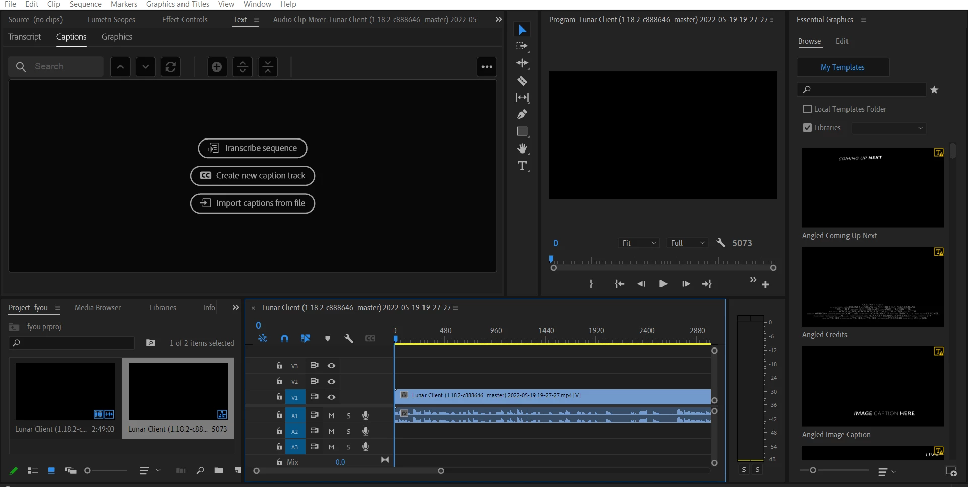

The bars on top are not there, so  i can not edit. How can you fix this???? I want to get into the edit tab, but can't. Please help me (PS: LOOK ON THE TOP WHERE THE BARS ARE SUPPOSED TO BE)

they changed the entire header in the New update to give us a little more Real Estate.
On the top bar on right side you will see THREE icons. Maximize window, Quick Export AND WORKSPACES. If you select Workspaces. drop down you can quickly switch. from One Workspace to another.
You can also change this to Tabs (select "Show Workspace Tabs" so it almost resembles the header you are used to.... much smaller though.

i dont see three bars look in the image

You may want to go to the top of the interface. Window/Workspace/Reset Workspace to saved layout.

This is weird. If Rob's Workspace reset, does not work, I'd try reset preferences.
In the screenshot, there is nothing where the old Workspace horizontal bar was (with a Home button on the left pre-"New" bar); and nothing where the new "Import/Edit/Export" and Workspace button is now.
