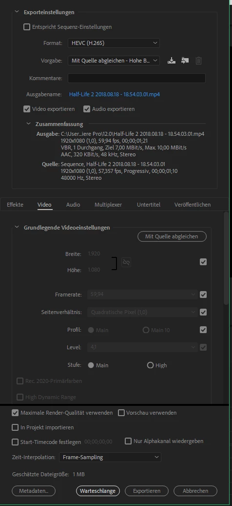

I have the problem every time I export an Video it is way too bright
I'm currently using these settings to export

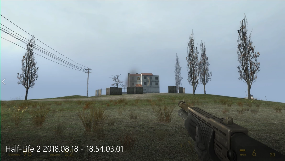

Before editing:
https://ibb.co/hPTadK
After editing:
https://ibb.co/kVVXQz

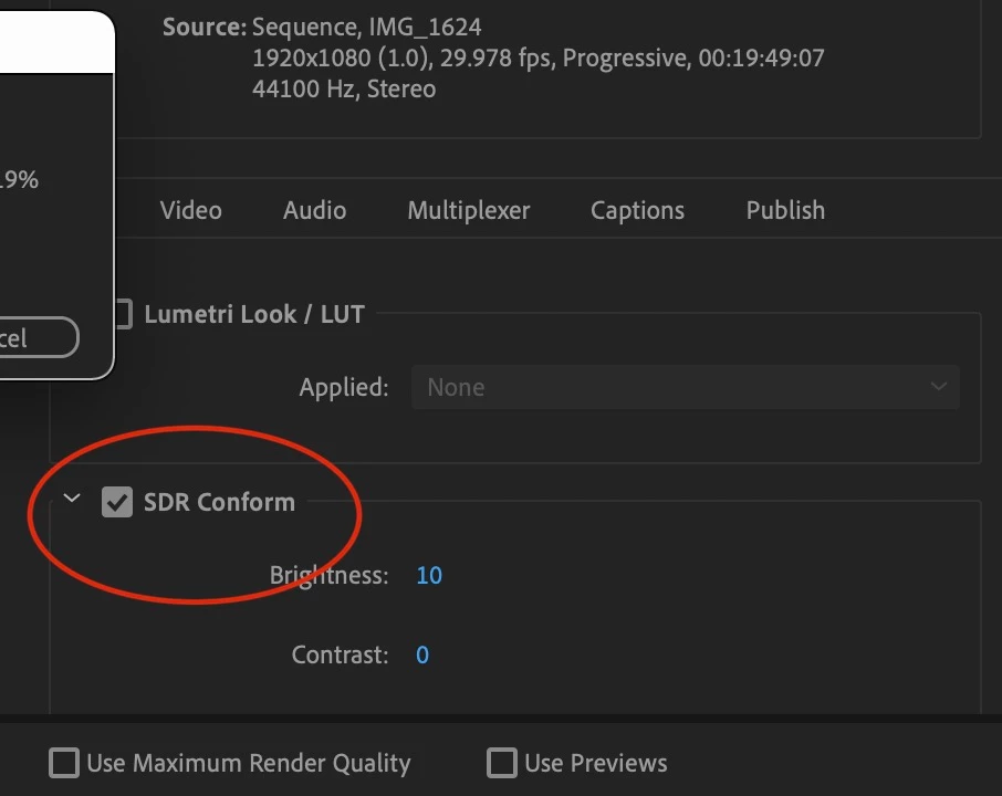

Hi! I had this problem too, when you go to export make sure that SDR conform is checked and it should work 🙂
Feb 9, 2022 12:30 AM UTC
Thank you for posting this, Erin. This just saved me so much time trying to figure out what the heck was going wrong with my export 😉

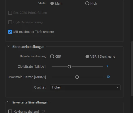

I would keep what you got for export but uncheck "max render quality" and try export. Apparently that setting does not do what it implies ( that it will be better ). That might solve your problem with brightness.

looks like 10-15% brighter. maybe you can post your export settings... you should not use 'max bit depth' I don't think. Some others can probably help more cause I have old version of PPro ( cs6).
Aug 19, 2018 7:10 AM UTC
These are my normal export settings

Aug 18, 2018 8:58 PM UTC
1)When I put it back into PPro it looks a bit worse but not that bright
2) I think it's like 20-30% brighter
I'm using Windows 10 Home
Before:
After:
I know that this is an bad example (buton YT it looks a lot worser) if you look at the shotgun you see at the second picture it is brighter
