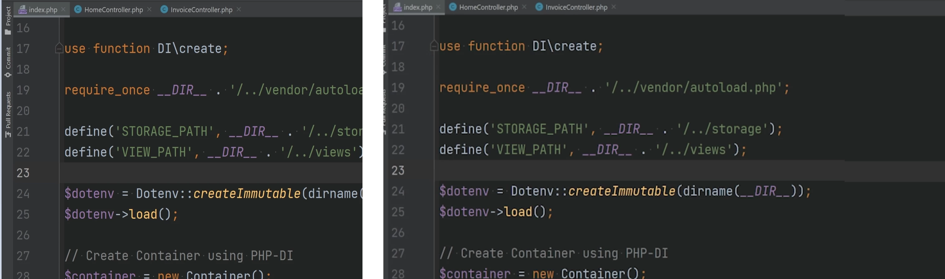

I've been at this for many hours now and I've tried a lot of export setting combinations. The result comes out blurry. You can see in the screenshot here, on the left is the original footage recorded in 4k and on the right is the exported version of it, as you can see it is a bit blurry & not as sharp as the one on the left.

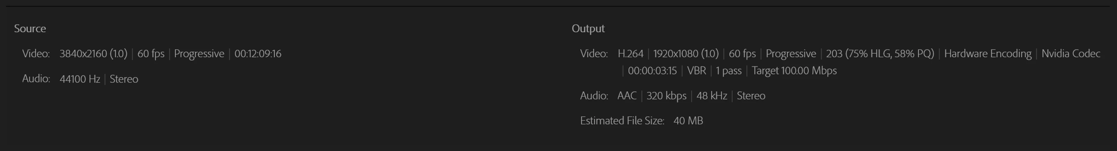

I tried exporting in 4k as well as downscaled it to 1080p but same outcome. Here are my recent export settings:
I've tried VBR-2 pass, CBR, tried lower & higher bit rates, tried software encoding, hardware encoding, etc. I've also tried using 1080p sequence and used "set to frame size", still same outcome. I'm out of ideas on what else to try. Any help is greatly appreciated, thank you.

What is your export profile and level set at? Can also try swapping to Software Encoding and see if that makes a difference? (Note: I'm not saying this is a solution, this it just a troubleshooting measure)
Gio08Author
August 25, 2022
Profile set to Main & Level 5.1, Tier set to High. I've tried Profile High, Level 5.2 & even H.265 codec, same outcome.
What I did notice is that when I did an xport in 4K using 100 target bit rate & VBR 1 the quality came out really good, almost identical to the original footage. Certainly better than the 1080p one. It's strange, I thought that downscaling 4K to 1080P would result in better quality especially when zoomin in parts of the video.

H.264 is a highly compressed codec, and results on video with fine lines (like in the screenshots you showed) might not come out well. Have you tried a 10-bit codec? Try a ProRes 422 export and see how that comes out. Let us know if it works.
