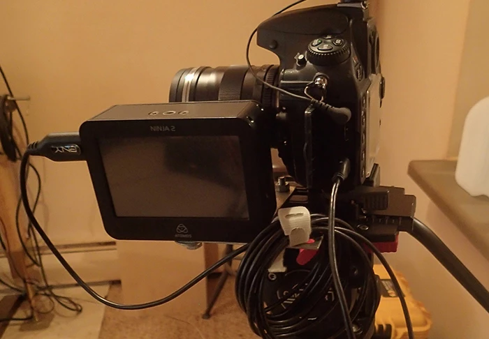

with regard to proxies... if your nikon is like mine, it is 8 bit 4.2.0 with a low bitrate compared to the 10 bit space and bitrate of atomos ( taking uncompressed signal from hdmi out to atomos). In other words, even though the color is the same ( 4.2.0) it gets put into a 10 bit space with higher bitrate. So everything you add to that edit will be slightly better in PPRO, when using effects, added source materials ( graphics, etc. ) and so on... your proxy may limit you to the same 4.2.0 space with low bitrate.

MOV is a wrapper. It can have H264, Prores, or DNxHD as 'codecs' within it. You probably have ( with nikon dslr SD card ) H264.
My personal solution, using Nikon D800, shooting full HD, is an Atomos Ninja connected via HDMI output of camera. I have windows so I record DNxHD. However, it also records Prores. I would stay with full HD and prores 4.2.2. 10 bit if you want real smooth editing.
Using the atomos means also getting an SSD for it so you have to be able to afford it, know what your computer can handle the larger byte count files ( H264 is super highly compressed into small files, hence the SD card ).  Good luck.
