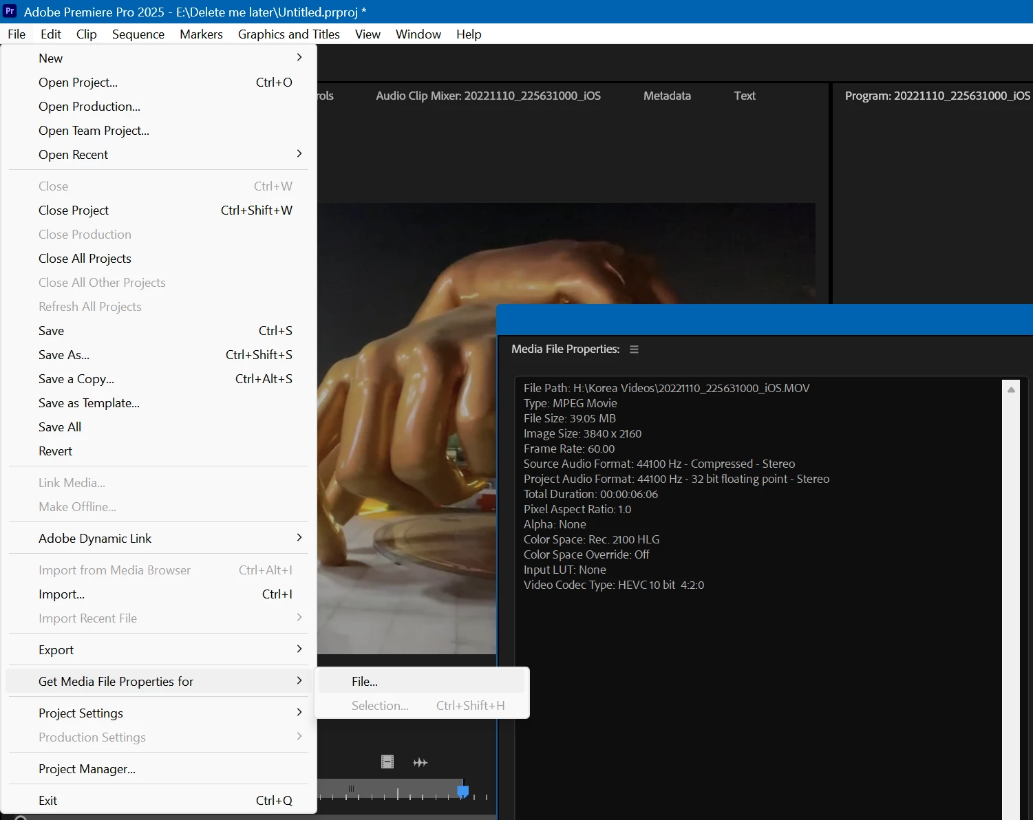

Ok, what I had tested, is not what you just described, but I tried it just now;
I also make the assume when you say "preview window" you mean Source,  If so, I tried with in and out points, and dragged to an empty time line, and it properly created the sequence, and added the clip with the in and out points;  (as a side note, I found the 'fist' you were talking about,  never noticed it before)
For kicks; I tried doing the same thing from the program window, it it doesn't do anything (it was never designed to work from the program window).
You might be having a MAC version specific issue, and someone with a MAC will need to look at this to see if they have the same issue.
for the record, you can use the get property feature pictured here to get more info on the media file as that might lead to some insight, the tets file I used is listed here:
It might be relevant, but are the clips your working with error free / encoded with something you can trust?   it might be worth trying to run them through media encoder and making a new file out of them to remove the chance there is some sort corruption in the video file itself that you could maybe bypass by re encoding it with Media encoder to a different container/format/bit rate?  maybe worth a try....
