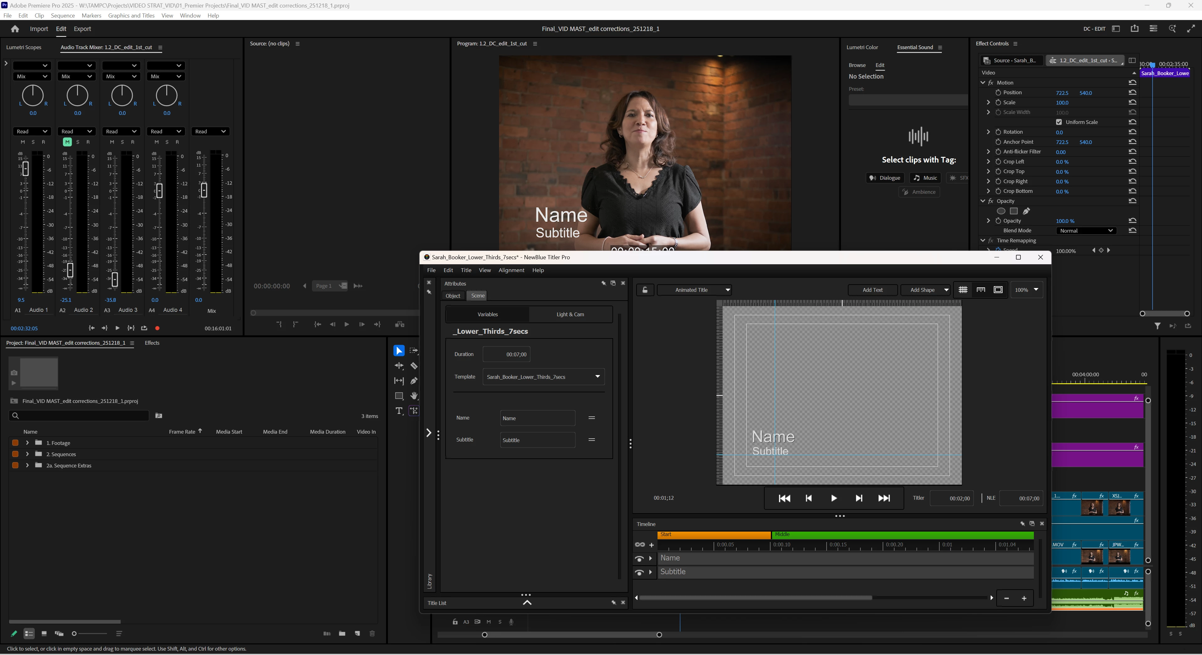

On the back of a previous thread I made (https://community.adobe.com/t5/premiere-pro-discussions/integrating-third-party-software/m-p/15644379#M576929) I now have NewBlueFX Titler Pro 6 integrated with my installation of PP.
But there are working problems - please note the attached screengrab.
When grabbing the effect and placing it on the timeline on the video track above the track where the live action is placed, then clicking the effect to open its UI, as you can see there is is no live action track showing within TP6's work panel.
Also, when closing TP6, PP then crashes and asks to send an Error Report.

I'm seeing the same behaviour - TP6 with Premiere 25.6.3 (build 2).  I used this combo 3-4 weeks ago without issue.
Your missing background video may be resolved if you use Elastic Timeline and jog the playhead in TitlerPro
Analyzing the crash dump it looks like a memory access violation associated with Adobe importerhost.dll - theres no reference to TitlerPro in the dump report
Please advise if you get anywhere with this.

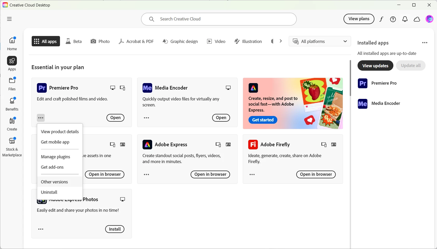

OK - it looks like this was an issue that started with 25.6.2
I down-rev'd my install to 25.6.1 and was able to edit a TP6 Title from the Premiere Timeline, exit TP6 and then continue without issue in Premiere.
I then upgraded to 25.6.2 and get the crash when I exit TP6
Down-revving again to 25.6.1 restored normal operation
To down-rev, open Creative Cloud Desktop app, click the three little buttons below 'Premiere Pro' then select other versions and choose 25.6.1 (Screenshot attached)
