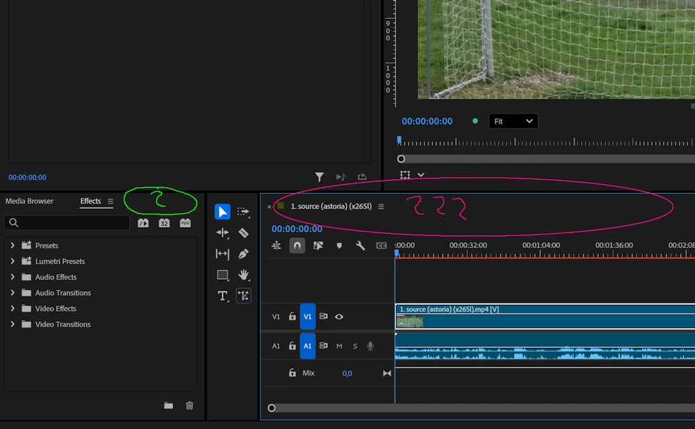

Problem 1: I had all my open projects (their timelines) in place of the red question marks. For some reason, it disappeared. How do I get it back?
Problem 2: I had a list of the clips in the project in place of the green question marks (it worked a bit clunky, but it was there). How do I get it back?
I use the Learning tab, if that matters.

I read your post. Try going to Window > Projects > (Your Project Name) and that should call up your project. Once you have that, you can double-click on the sequence icons to get your sequences back open. Let me know if the advice helps. Sorry for the hassle.
Kevin
