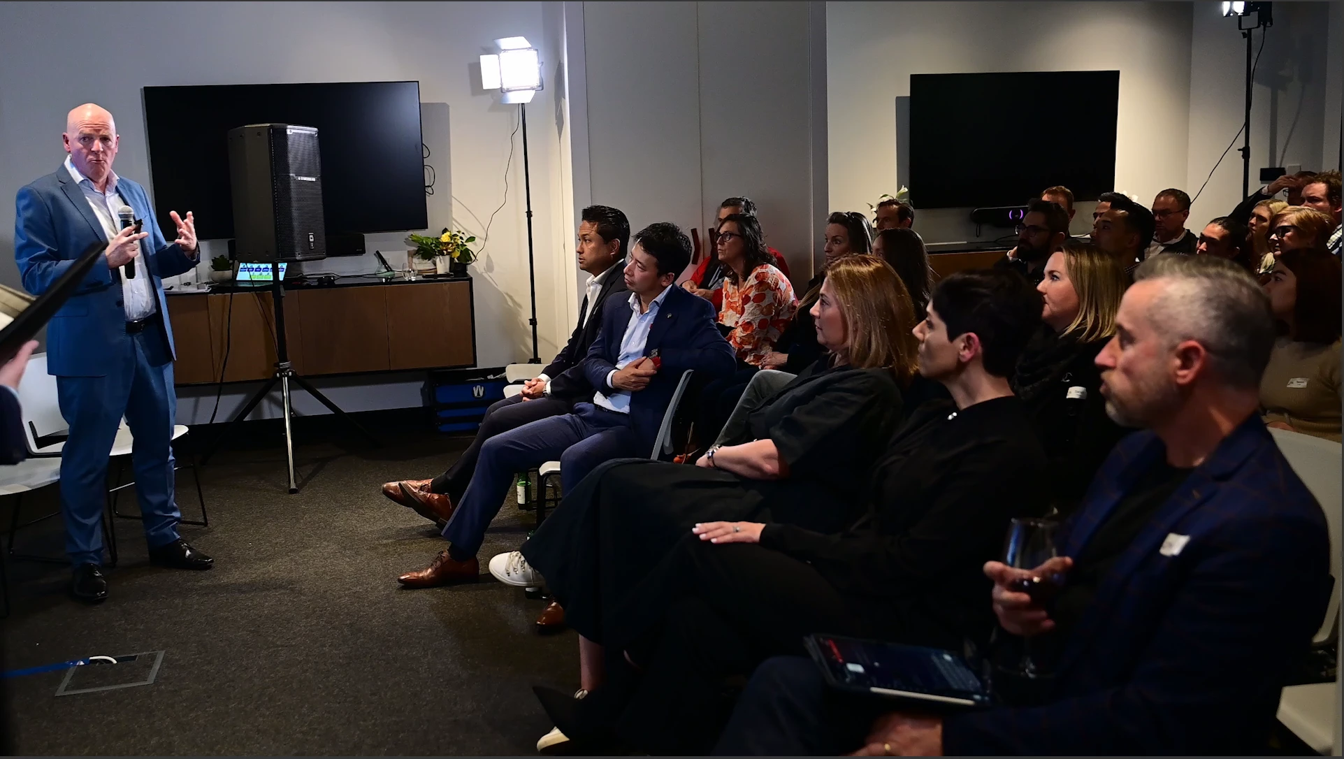

I'm having a strange problem with clips from a Nikon Z7 (H264 MOVs, not log)
The levels - most notably the blacks are crushed when importing the clips to Prem (or AE or AME), viewing in Quicktime Player or VLC.
You can see this in the first screenshot.

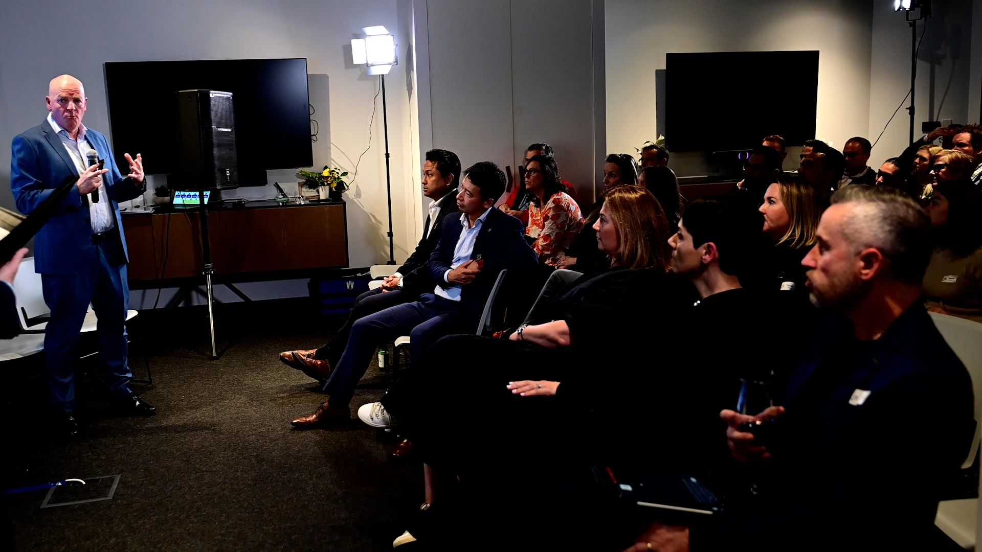

So I tried the same clips in Resolve, and WTF... the levels are correct!
You can see this in the second screenshot.

That looks like the files were tagged/written as Full Range, not Legal ... could you check by using the free utility MediaInfo app, then dragging/dropping one of the files onto that applet's desktop icon?
Then go into the "Tree View" and check for the range.
If they are Full, then ... there's a Lumetri preset that is Full to Legal ... use that on the clips, you won't lose any data, they'll just be displayed correctly.
"Full" and "legal" are a legacy thing, by the way. It does NOT affect how many levels are written to the file, only how they are coded in the file. Same data in both, no advantage to recording in full. Both files will display correctly 0-255 (8 bit values) or the similar 10-bit values, on properly setup systems.
And several camera makers are allowing people to set the range which then simply mucks up the post processing. As the apps and displays expect that YUV (Y/Cb-Cr) video is encoded 'legal' and only 12-bit RGB files are recorded full.
As someone who works both in Resolve and Pr, Resolve should be set to "auto" and will work with either file arrangement. It can also be set to one or the other among the many options.
