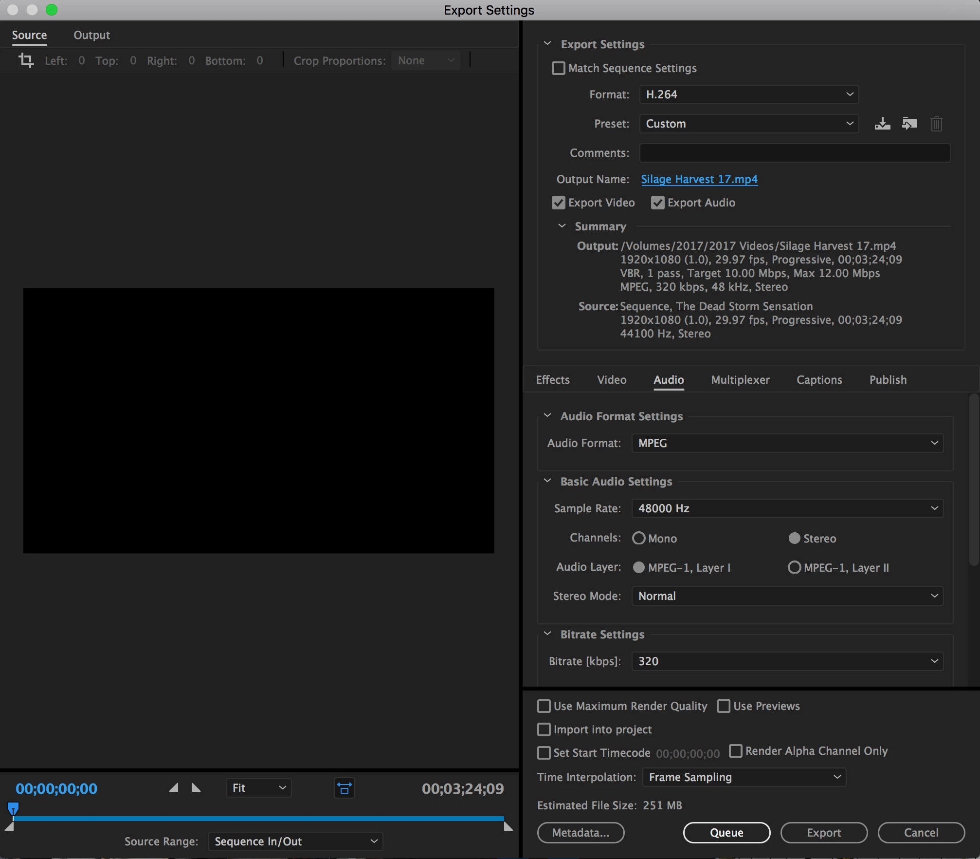

I just created a short video in premiere pro, on my timeline everything works perfectly: Audio and video. When I export, there is no audio. I am trying to export H.264, export settings shown below. I see that is is a somewhat common problem but I don't see anything that has fixed my problem yet. I appreciate any help.
Thank You!
Correct answer Ann Bens
Set audio to AAC and try again.

Did anybody find solution for this? i read all the threads and im exporting audio in AAC and the video keeps exporting with no audio, tried to unlink all the audios from video, tried to export only the audio. Nothing works! please help!
October 15, 2017
MPEG-1 Layer 1 is a reeeeealy old format.  It's possible your media player just can't play it.
I would agree with Ann.  Leave the default audio options in place.

October 15, 2017
Is AAC defualt? What are the other default options? If I changed anything, it was not on purpose.
Ann Bens
Ann BensCommunity ExpertCorrect answer
October 15, 2017
