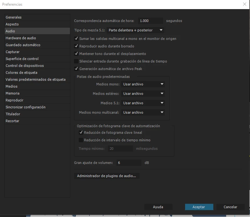

May 14, 2025
Hi! I happened to have this problem and fortunately I could solve it by comparing configs with someone else. You need to go to Preferences>Audio and make sure that the second option with a check mark is enabled (I use mine in spanish, so I don't know the exaxt name of this option, but is something like "Play audio during erasing").
Turns out there's a keyboard shortcut for this and it's shift+s, so if you by any chance miss-clicked it that option was disabled.
I really hope this is what you where talking about and that this sort of explanation helps you 🙂

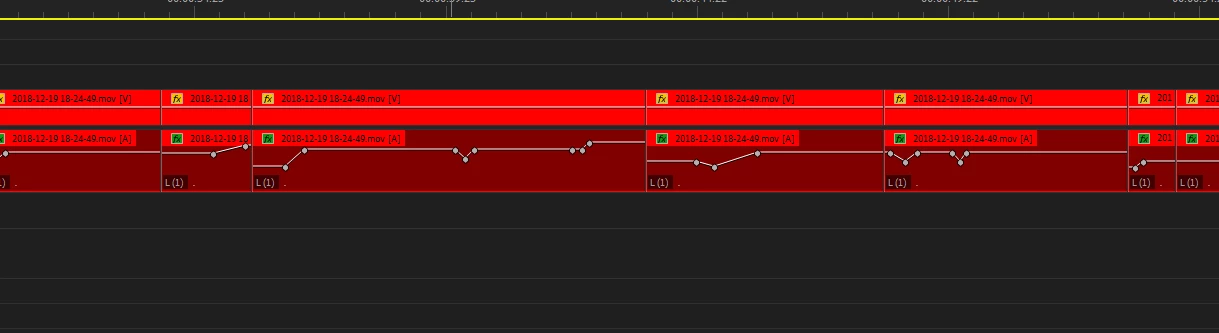

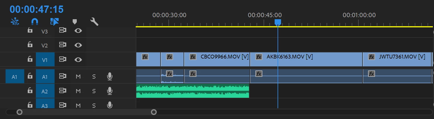

December 23, 2018
Just updated to Premiere Pro CC 13.0.2 hoping it would fix the dozens of other bugs and now my audio in a sequence on all layer 1 clips (That I spent A LOT time leveling with the pen tool) doesn't have a waveform and doesn't playback.... I've tried restarting my computer, soloing, muting, moving it, replacing the footage, reimporting. NOPE. The .mov h.264 file audio no longer works in Premiere Pro. Plays just fine from Windows explorer though...
It worked yesterday in 13.0.1. And now it doesn't.. I don't have any more time to waste on this completely unreliable 'professional' software. It's literally just one thing after another................................................... I was hoping after seeing literally hundreds of posts about issues in 13 and 13.0.1 that, and after posting several posts about other issues I was having, that this update would be better... should have known, I guess I'm to blame at this point.
It's so frustrating. I spend about as much time troubleshooting bugs and trying to get things to work as I do editing.
Can't we just got ONE update without issues? PLEASEEEEEEEEEEEEEE?
UPDATE** I managed to get the audio waveform to show up after I created a new sequence and copied everything over.. I also deleted the cache too and restarted Premiere Pro, HOWEVER, the audio still did NOT play.. I managed to get it to work by literally having to rename the clips individually, and then when they went offline because I renamed them, I replaced each one with the new named ones. That reconformed the clips and the audio worked again..
You are welcome Adobe for me doing some troubleshooting for you How about you reduce the cost until it works perfect?
