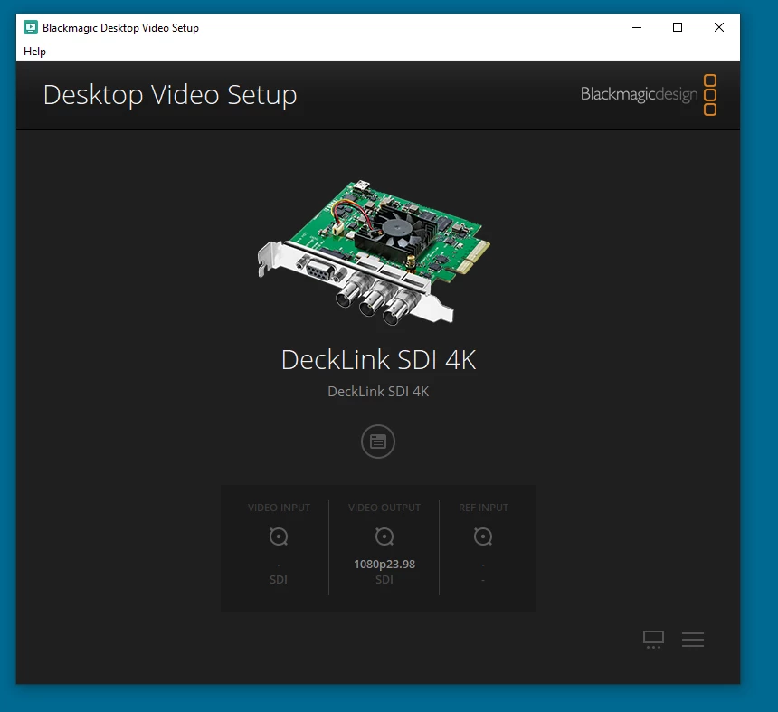

    When I open the Blackmagic video setup thing, I see THIS.
    Using resolve I get primary monitor (eiso calibrated to rec 709 2.2), secondary junk monitor (for other panels like scopes etc.) and video monitor via SDI ( pro monitor, but a small field monitor, like Lilliput works too via SDI... quality sucks on field monitor ).
    A while back I installed a mini monitor card that did not work for SDI output. Only Hdmi worked.
    I think there's weird stuff where hdmi gets passed through the pci slot from graphics card or something, so a TV works, but the SDI doesn't.  That's one reason I upgraded to the 4k thing.
    You should be seeing an option via video desktop (under Blackmagic programs in 'programs' ) similar to what you see in pic above... but with your own specs for SDI output, etc.
