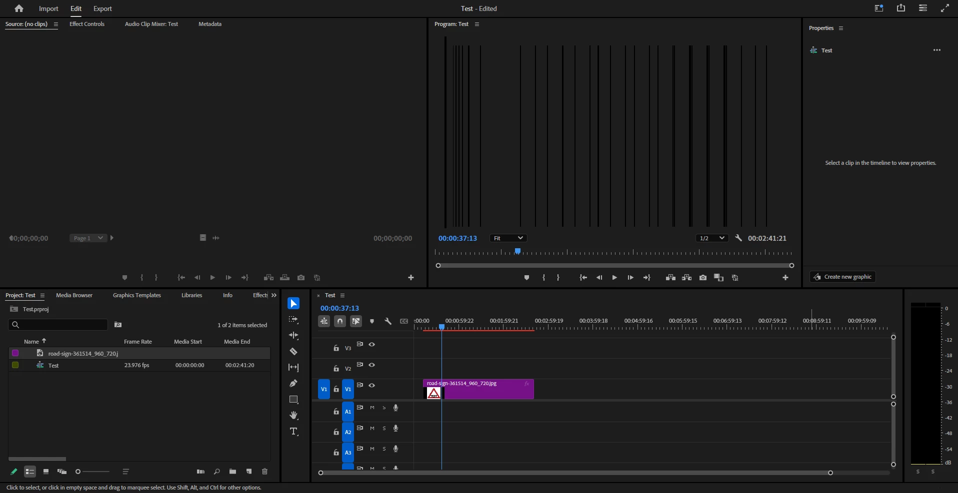

No playback at all.
1. Adobe Premiere Pro 25.0
2. Windows 11
3. Open Premiere, start a project, import a simple JPG file, create a new sequence, drop the JPG into the sequence.
4. Nothing shows up in the Program or Source windows.
I have tired everything.
Even after reinstalling Windows 11, Adobe CC, Adobe Pr, Nvidia drivers it still doesn't work.

The lines on your program monitor look like a driver issue - perhaps
Although you re-installed windows and Premiere there may be some corrupt display files lurking around on your hard disk

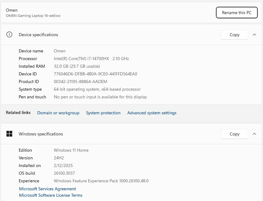

Just did a clean reinstall of the Nvidia graphics card.
WIndows 11 24H2 is the currently installed version.
I have the NVIDIA GeForce RTX 4070 Laptop GPU, and the driver version 572.16 is up-to-date.

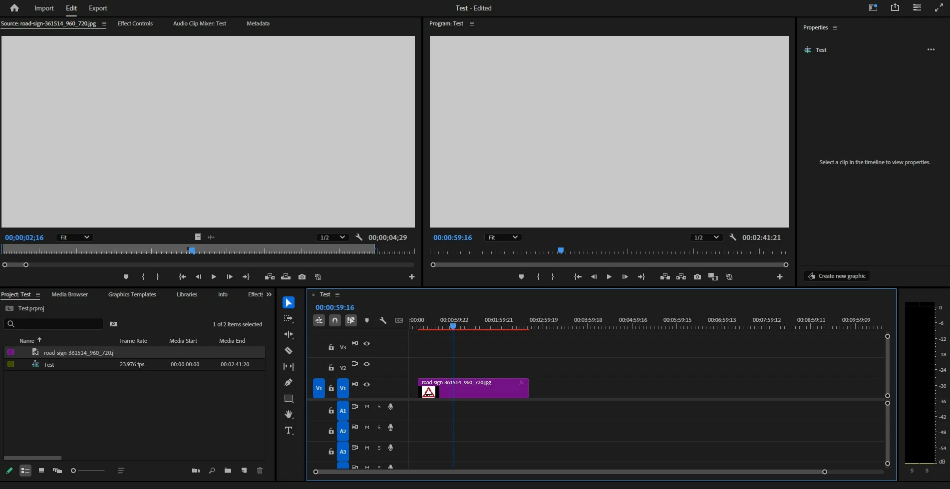

Have you checked the Program monitor Wrench tool - bottom right to make sure it is set on Composite Video?.
What resolution do you have playback set to? - Full /half ??
What happens if you double click one of your H264 test clips in the Project window?
The Source window should open and display it - does it?

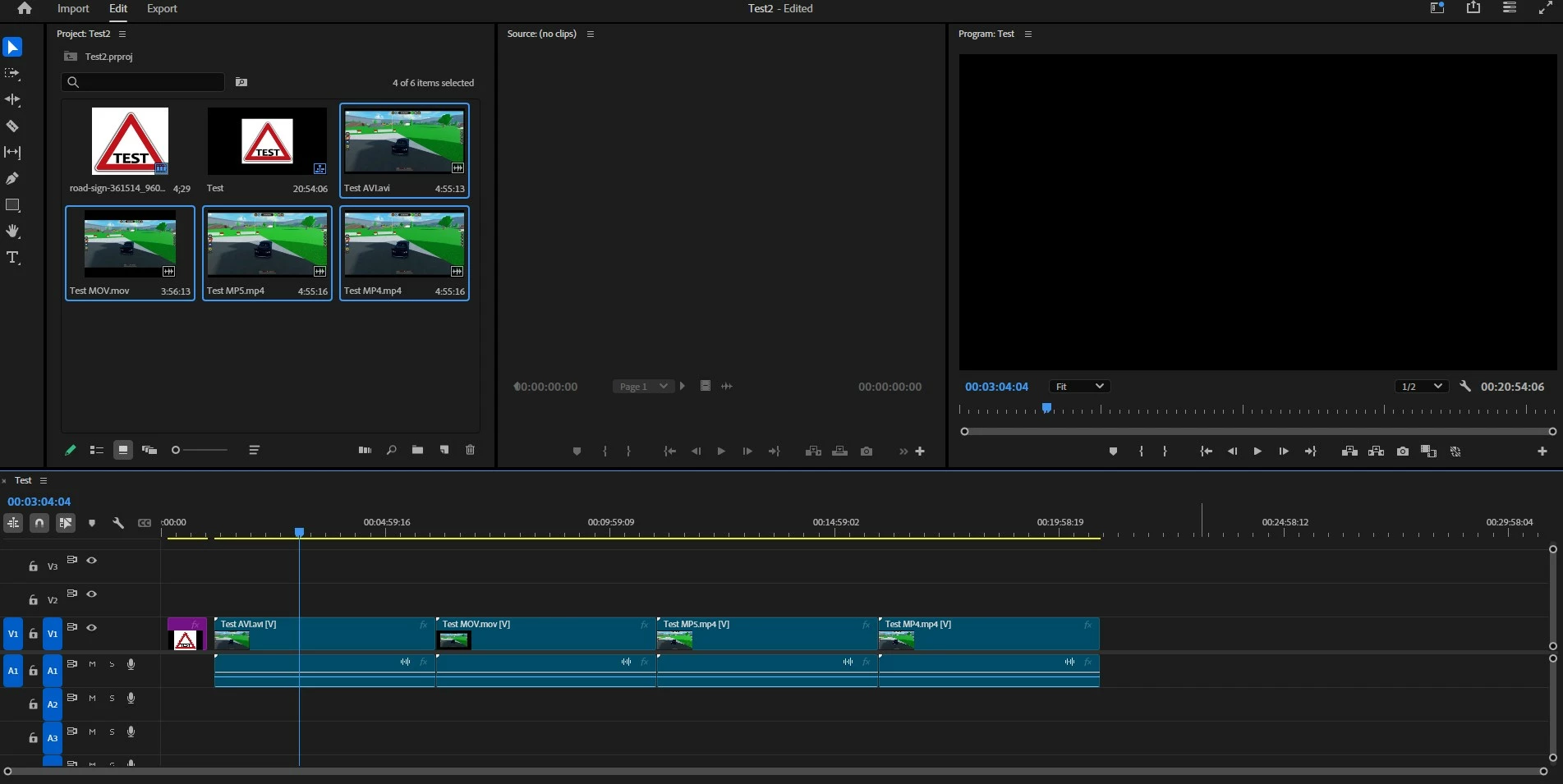

Thank you for the reply and for your help. I used a JPG as an example, because of its universality. I have tried the most common video formats, MP4, MOV, AVI, MP5, etc. The same problem persists.
Yes, I didn't have these issues a few months ago.

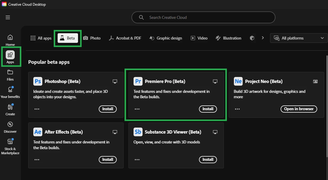

How do I go about installing the Beta version? Through the Adobe CC service, yes? Can you point be more directly?
-Nick

The beta is here:
quote
By @swedlunk
