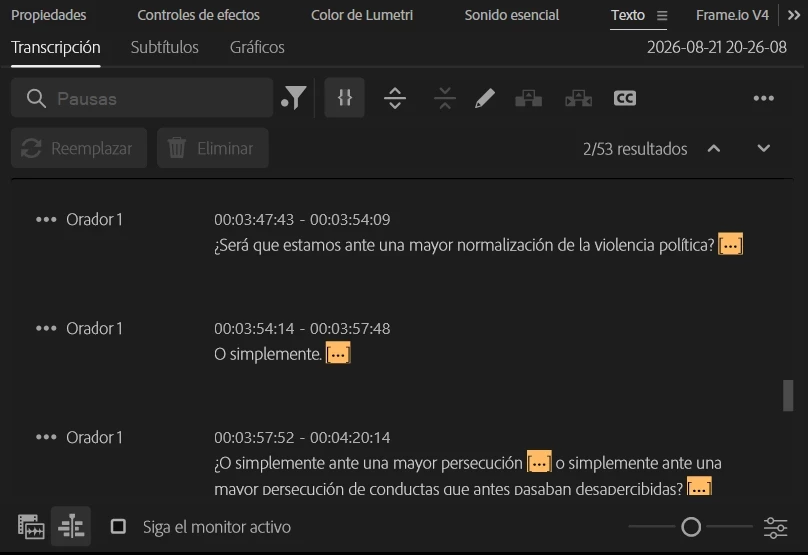

No puedo quitar silencios
Luego de transcribir una secuencia no puedo eliminar los silencios. Simplemente la opción no aparece habilitada. Apenas se lo básico así que si alguien pudiera ayudarme con peras y manzanas seria muy útil. Gracias de antemano

    “After transcribing a sequence I can't remove the silences. Simply the option does not appear enabled. I barely know the basics so if someone could help me with pears and apples it would be very useful. Thank you in advance”
    Hello!
    From the looks of it you are looking at the SOURCE side of the transcript. In order to make edits you need to put the clip into a sequence, then you can remove things like silence/pauses, curse words, speakers, etc.
    Basically the raw/source is always left intact (outside of speaker name changes and spelling corrections) so you need to actively be editing it in a sequence to remove things.
