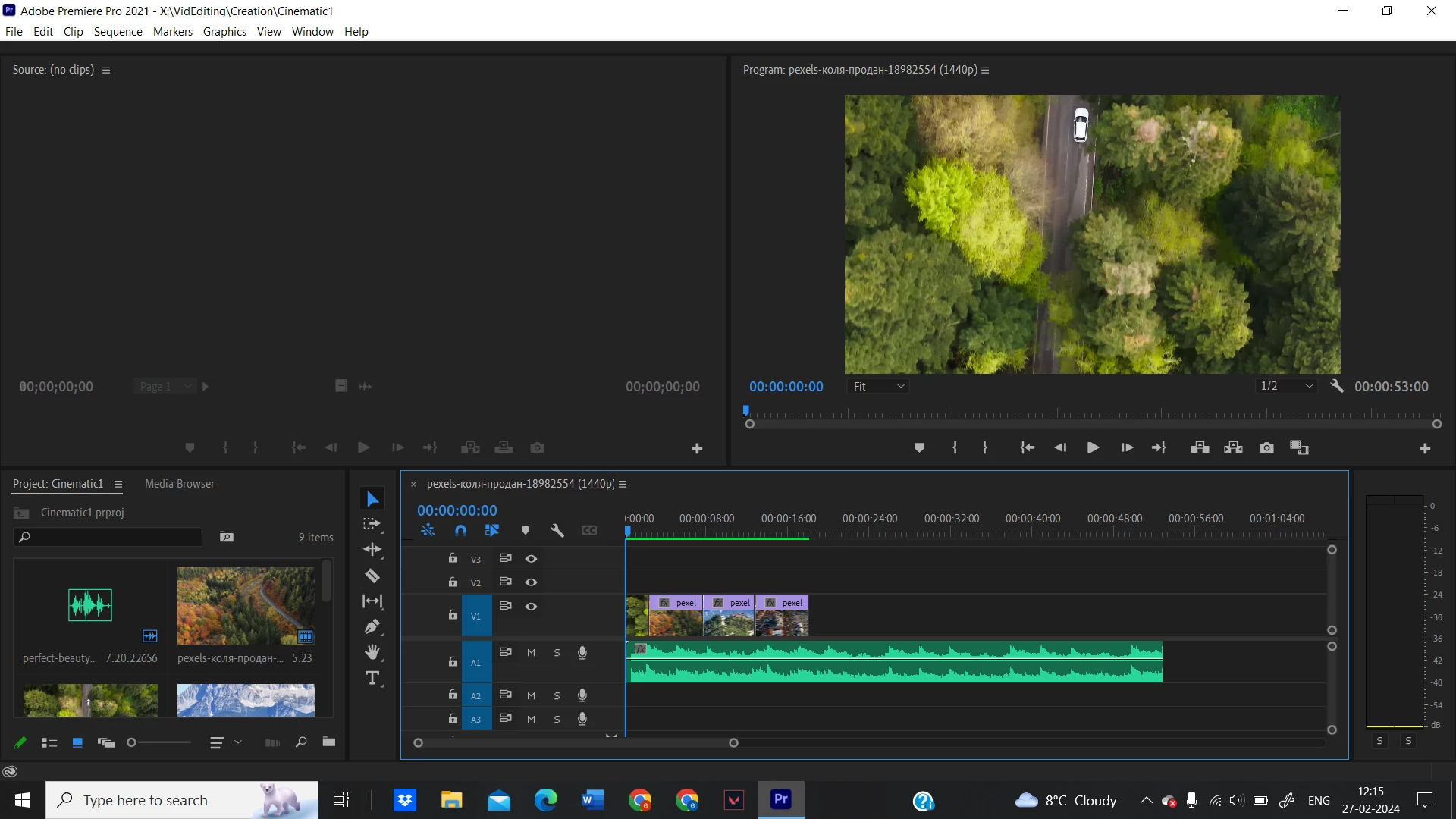

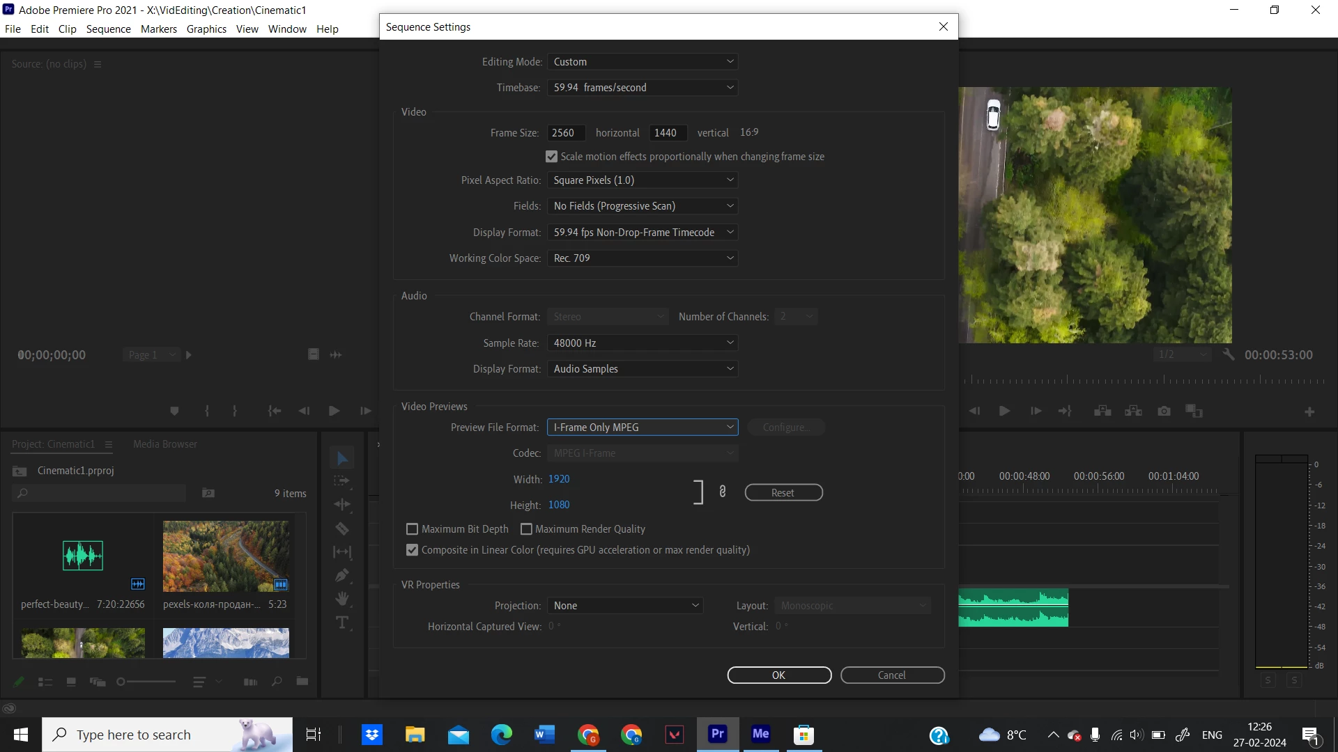

Here is my demo project.

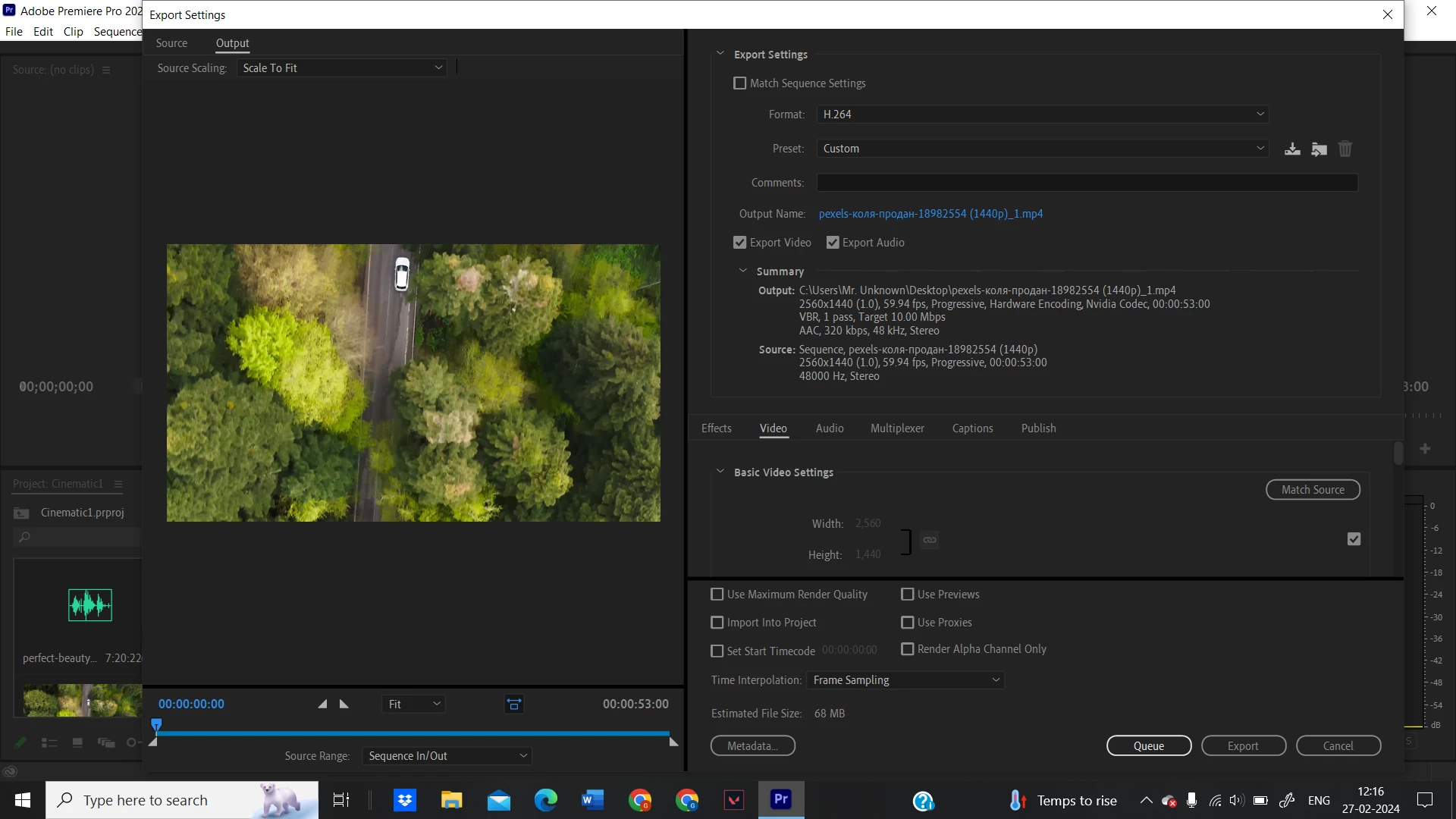

See if these screenshots help. I have tried software encoding and then my project exports perfectly with audio and video,but it takes too long to export. My laptop(HP Pavilion Gaming 15) has a Nvidia GTX 1650 4gb graphics card, so hardware encoding is definitely possible, but it isn't actually happening.
I'm using Adobe Premiere Pro 2021 version and Adobe Media Encoder 2021 version as well.
The clips i have added are downloaded from mixkit.co website.
