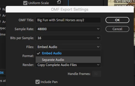

Hoping somebody can shed some light on the best way to do this.
Planning on making an omf for each track to avoid the 2gb limit. If I disable the tracks I'm not using before exporting will they not show up in the omf? Just want to make sure everything is clean and obvious for mix.
Thanks!
Correct answer Michael Grenadier
Just change your options in the omf export dialog to separate audio.   voila, no 2 gig issue cause the audio files are not embedded in the omf.

Michael GrenadierCorrect answer
February 29, 2020
wyattwAuthor
February 29, 2020
Lol yes thank you. This is what I ended up doing.
I had just read a bunch about people splitting them up into multiple omfs.
Just the first audio track exceeded the 2 gig limit with handles so
yeahhhh. Feature cherry popped.
