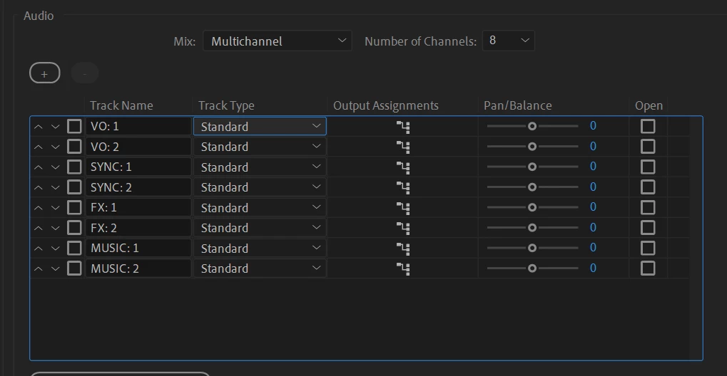

Hello guys,
I'm having a problem where while working on a MultiChannel sequence with 4 channels (8 tracks) I'm only hearing the channel 1, but the Audio Track Mixer is displaying the levels correctly as if everything is fine.
It's like the rest of the tracks are disabled(?)
(2 tracks per channel, both stereo)
My final goal was to export each audio track/Channel as a .wav file and this seemed like the correct option but I can't really edit without hearing the rest of the tracks.
Anyone knows how to the fix this? or maybe a workaround?
Thanks!!

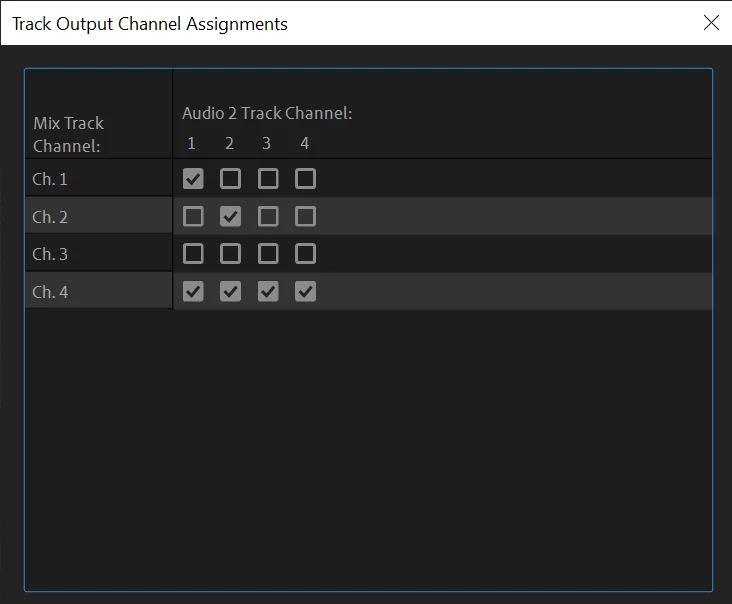

Okay, just found a worksround, for anyone with the same problem.
Seems like premiere only previews the Channel 1-2? maybe a bugg maybe a feature
If you just set up the Tracks as Adaptive and select the channel you want + 1&2 you can hear the track as normaly
I'm not very knowledgeable in terms of audio so maybe this is just overcomplicating and there is a simpler solution, either case this worked for me 🙂
