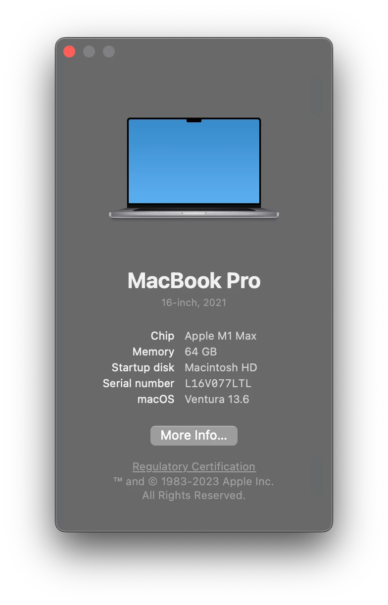

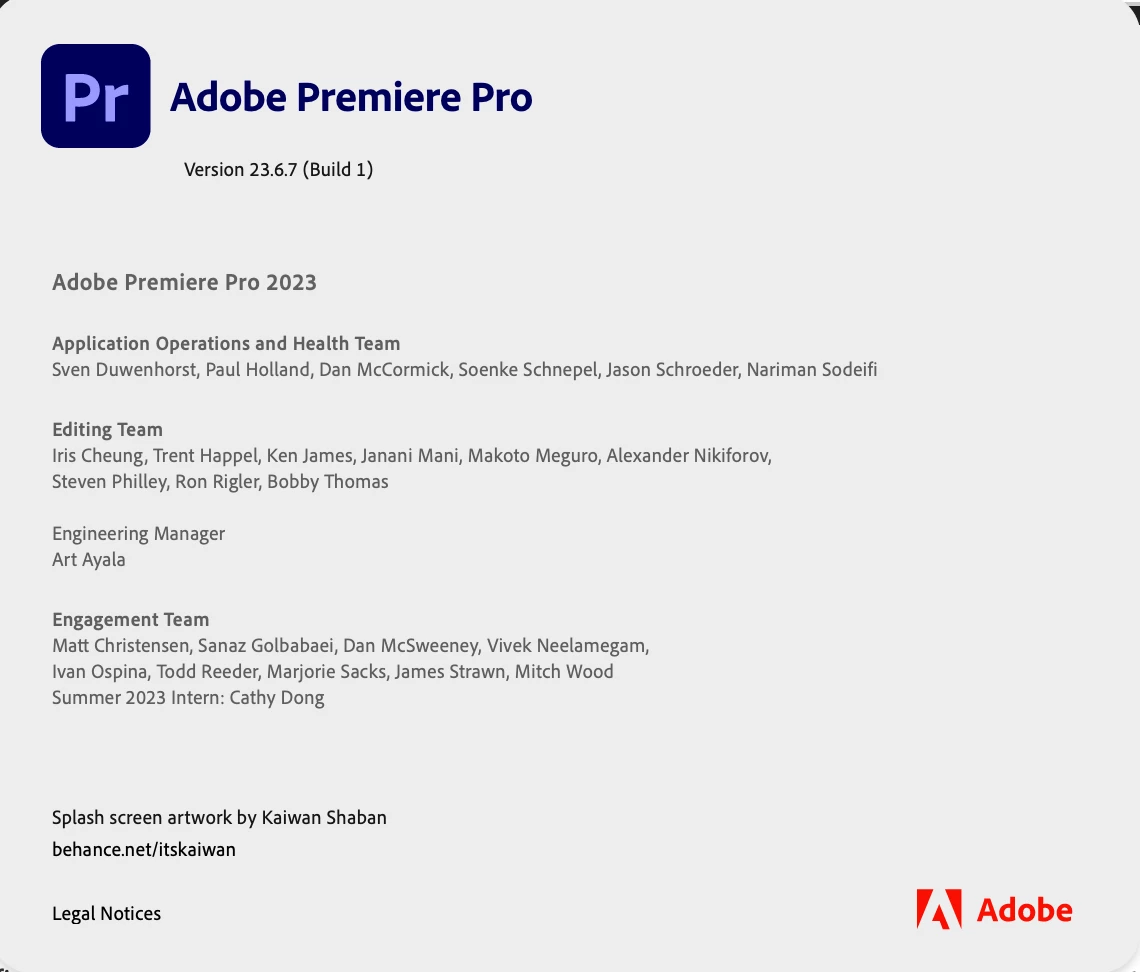

Working on an M1 Max MacBook Pro 16" running Premiere 2023.6.7. Mac OS Ventura 13.6.

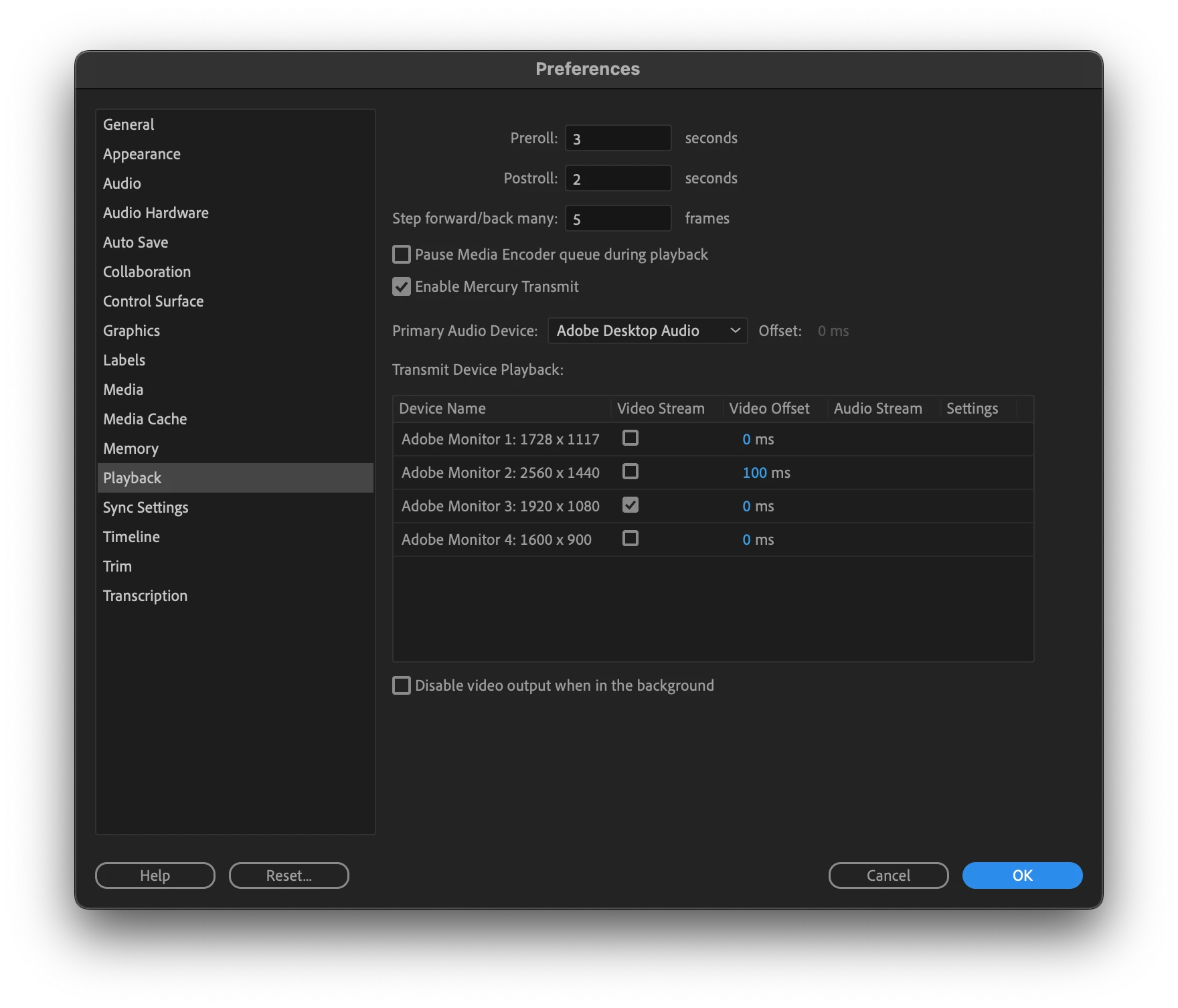

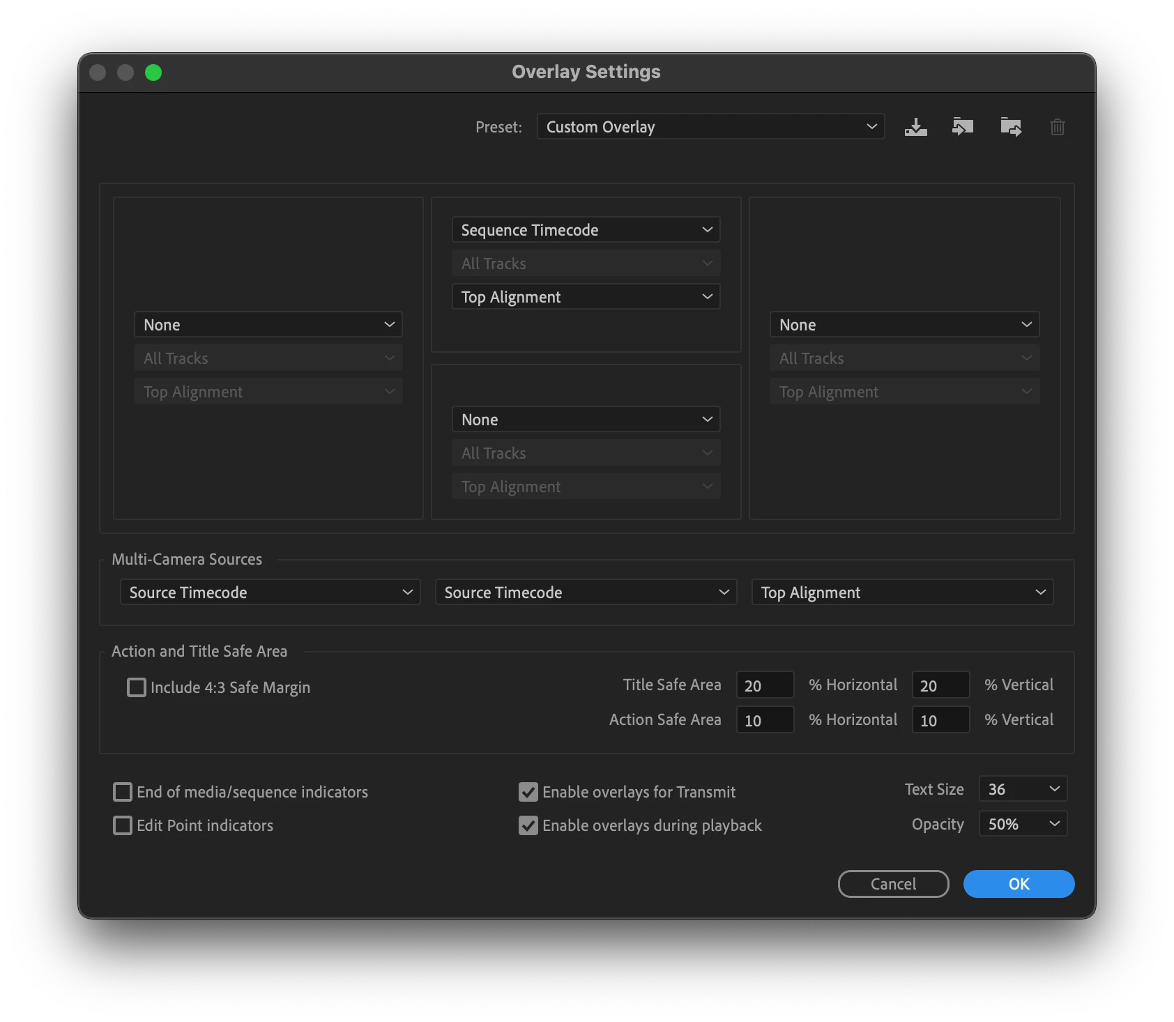

See screenshots for overlays settings.

Hi @JoshG_Edits_TM - This is a known issue and has been fixed in version 24.1
