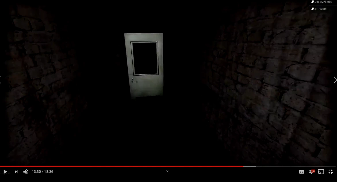

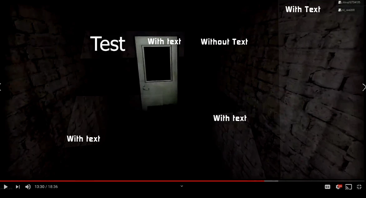

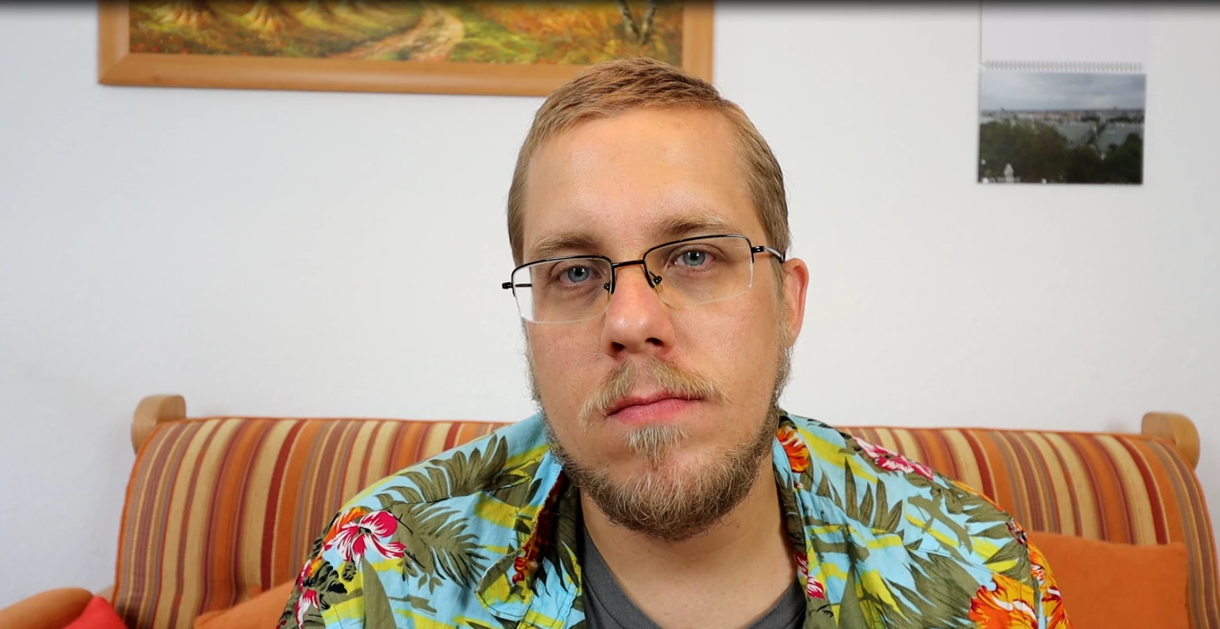

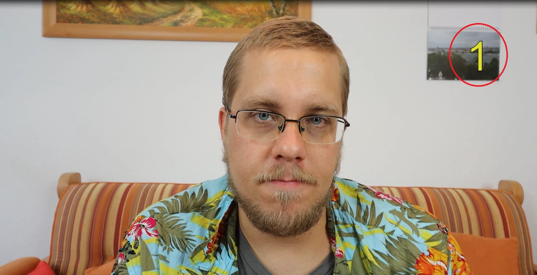

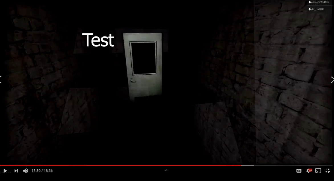

I am having the same exact problem. Heres two screenshots showing them:
If that didn't do it, I put together an image that has masked* parts of each photo (The first has annotations marking each place there is a mask.) :
Annotated Image:
Non-Annotaded (No extra text) Image:

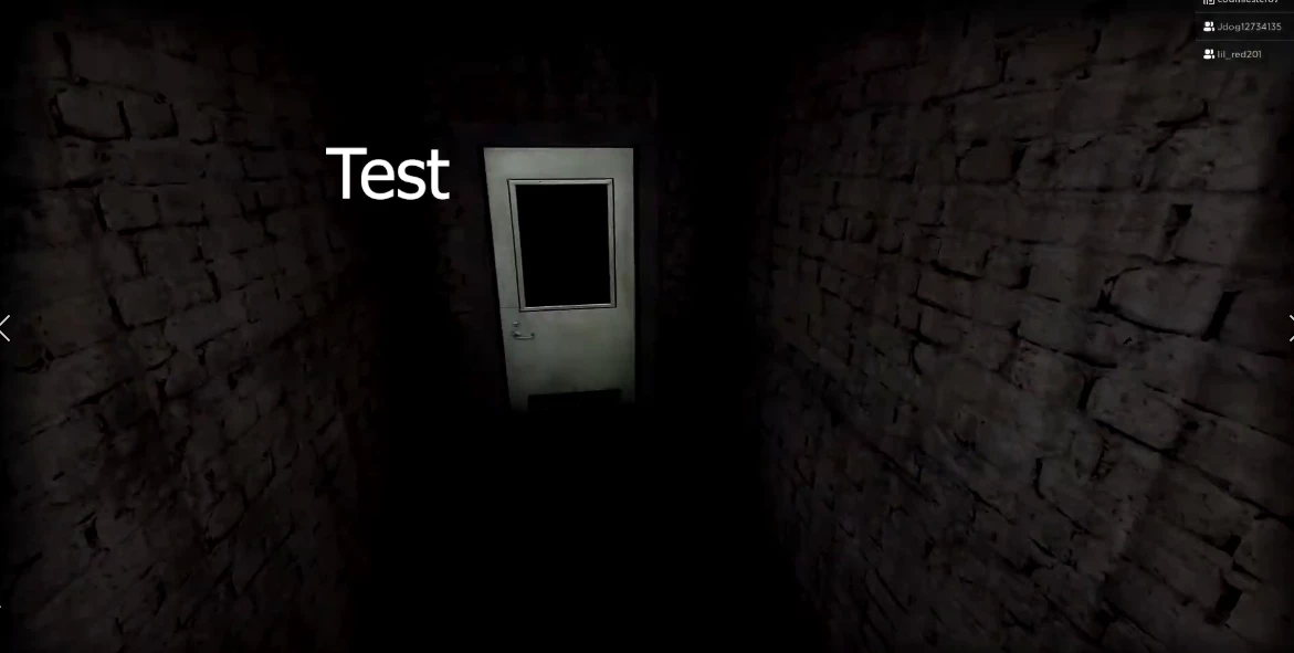

Just to confirm, you've rendered the same video with and without text and you can see a brightness difference with the same output settings? I don't think anybody is going to download your file, maybe put two up on YouTube and link that to show the comparison between the two
Aug 31, 2020 2:43 AM UTC
To clarify, the issue only occurs when the text is on the screen. Again, only while the text is on the screen. Before and after, it's perfectly fine. There is no need to upload two videos, in my opinion. The issue is pretty clear if you watch the one I attached. Not to be rude, but why would there be an option to attach a file if people won't look at it? All it is is a five-or-so second video that showcases my issue.
I don't notice the issue while I'm playing back the video in Premiere Pro. It only happens after I export it out to my computer.
Edit: Here's a link. After watching, it seems maybe it doesn't make the video brighter as it does with my gameplay videos. Maybe it has to do with the contrast? I'm not sure. I'm pretty new to all of this.
https://www.youtube.com/watch?v=QQxTg5LwR-s&feature=youtu.be
Aug 31, 2020 3:14 AM UTC
Just generally as someone on the internet, if I click someone's link and it prompts me to download something - I'm probably not going to do it. There is an option to embed the video into the post, which is a better option.
But I can see how it's confusing to have the option to attach a file when you make your post.
Anyway: I would be curious about your export settings. I've seen this text brightness thing on other people's videos, but admittedly I don't know what is causing that from Premiere. It certainly isn't normal or expected behavior.
