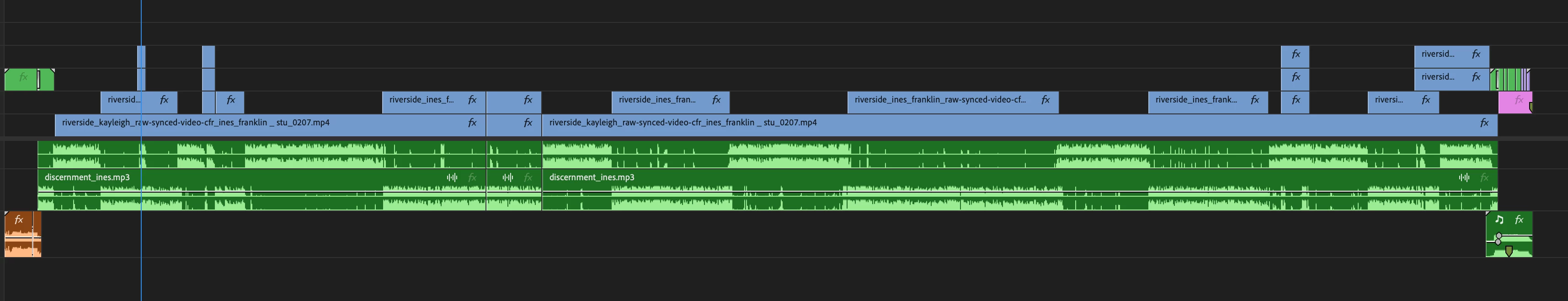

I have opened Premiere Pro today to find all the label colours in my timeline appear to be inverted. The lighter colour is now the main body of the clip and the darker colour is now the waveform. I have tried to go through all the different label group styles. I have also tried uninstalling and reinstalling the application. Does anyone know how to get this back to the default colours.
I have attached an image of what it should look like and what it looks like now.

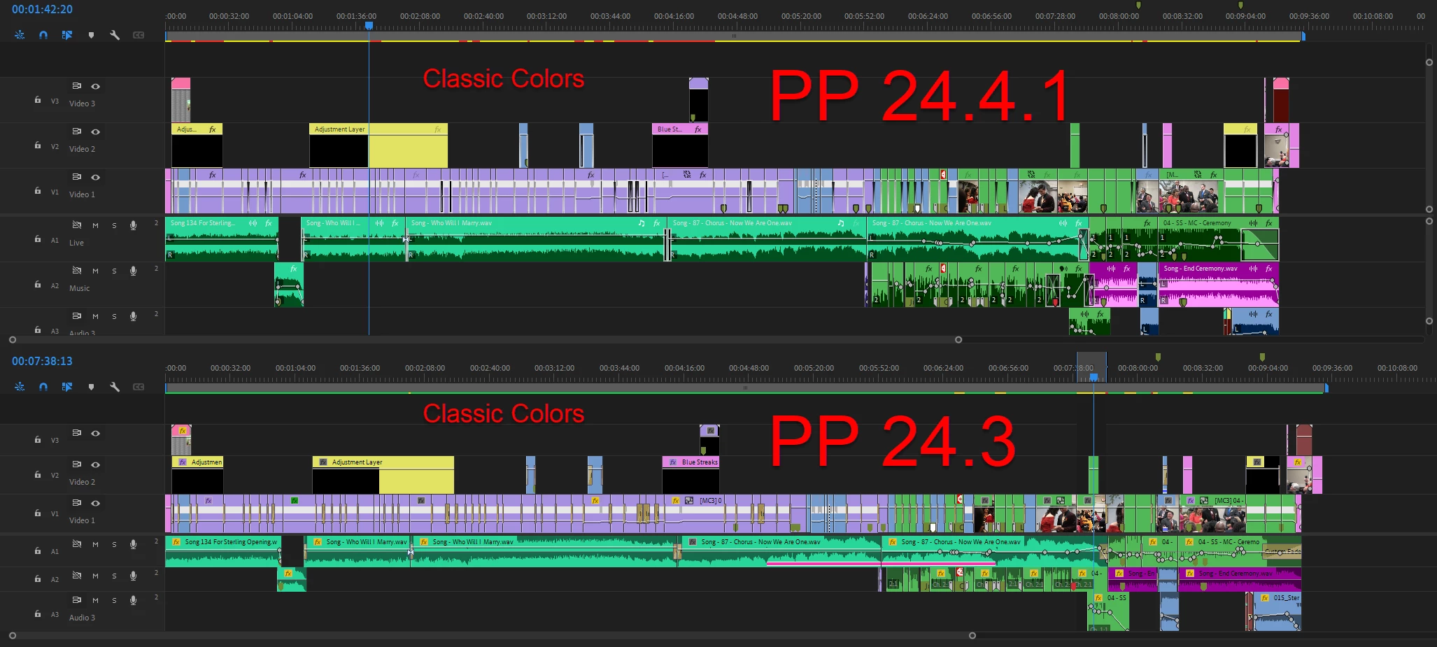

Earlier today I updated from 24.3 to 24.5 and was shocked with how the timeline looked. I tried going back to 'classic' and the colours were then ok, except for the inverted colours on the audio timeline. But what's going on with the waveforms!? Comparing the waveforms above, which are of the exact same audio, they look really small and squashed in 24.5 with the left and right audio not having equal height.. I can't edit with them looking like that as I can barely make anything out, so I had to revert to 24.3. The below settings are how I have them, it's even worse if I untick 'Logarithmic Waveform Scaling'.

Thanks, I will try a dark colour when I install it again. Though I'm more concerned with how the waveforms look, it was really hard to make anything out.

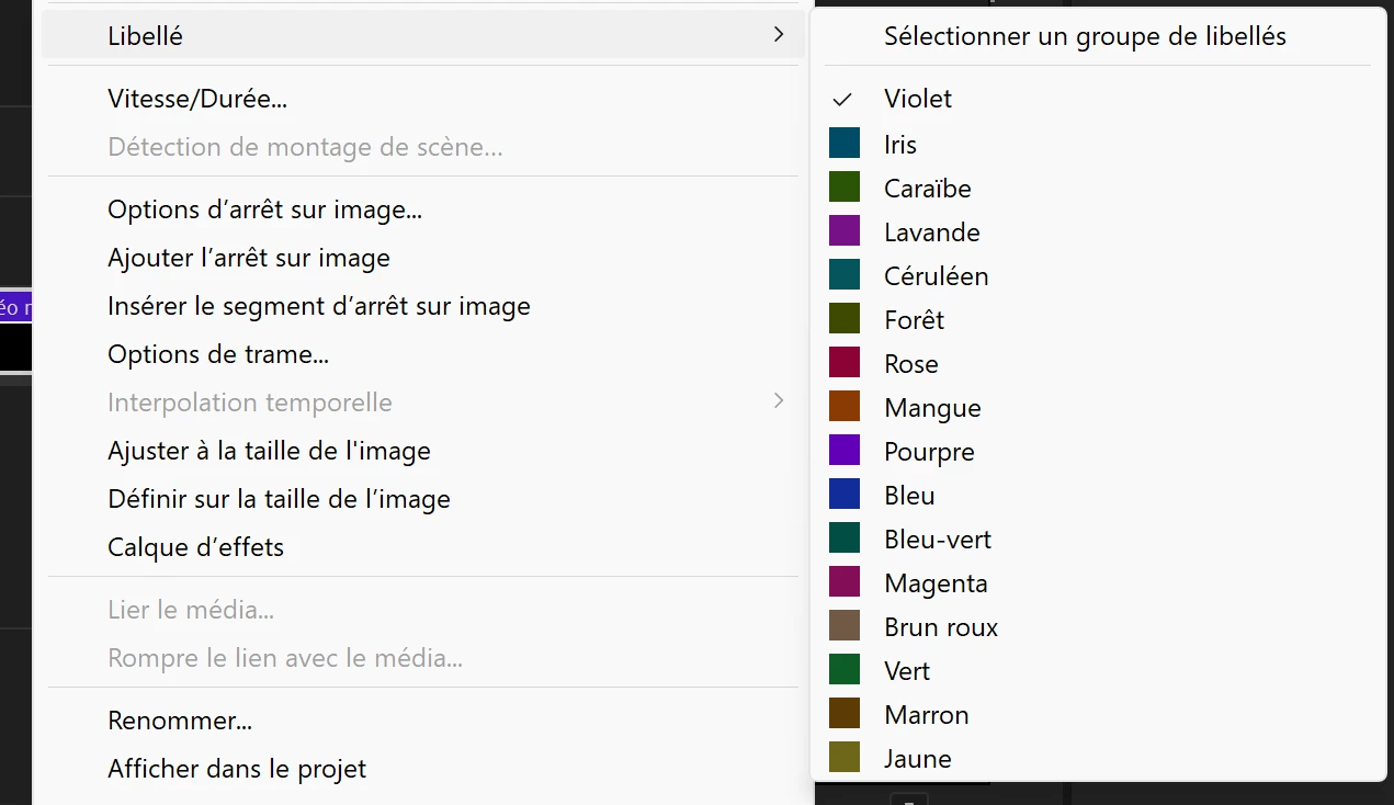

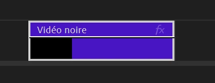

Bonjour, j'ai un problème concernant la couleur de mes clips , ceux-ci n'ont plus la même couleur par défaut. Je travaillais sur mon portable, et puis je m'étais connecté sur une grande télé OLED pour mieux travailler, Depuis que je me suis débranché de celle-ci. La couleur bleu - de base de mes clips et même toute les couleurs libellés de mes clips de sont plus les mêmes.  Que devrais-je faire ?
Jun 19, 2024 9:49 PM UTC
et je tiens à dire que sur les photos envoyés, les couleurs ne sont pas les memes que ceux que moi je vois. Voila pourquoi je ne comprend pas.

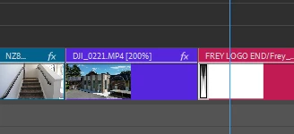

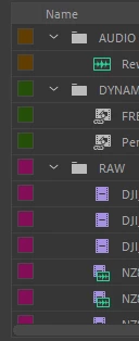

I was excited when Premiere updated the colors of the layer labels. They look great in the timeline, but why do they look so horrible in the Project Bin window. I color code everything and for some reason the layer labels look like garbage - almost all the same tone, just different shades in the project window. Is this an error/oversight on Adobe's part or is this just a me problem?
Photos to show!

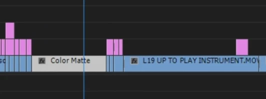

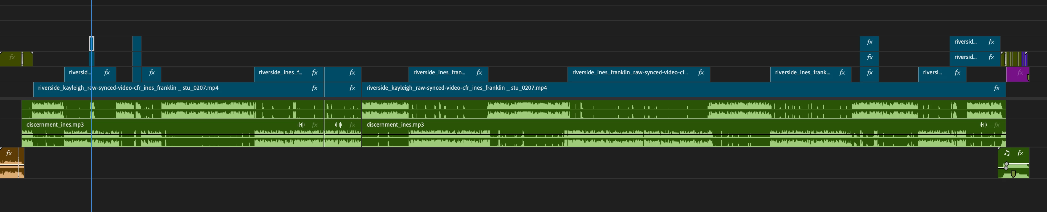

Jun 8, 2024 11:21 PM UTC
Before:
Now:
I've changed the presets, I've changed the defaults. I have reset everything. The only thing I have not done is a reinstall, because it ruins my workspace (I know I can save and load a workspace, but that straight up doesn't work.). No matter what I do, the colors show as some horrible shade of blue, even if I set every default to pink.
How can I fix this?

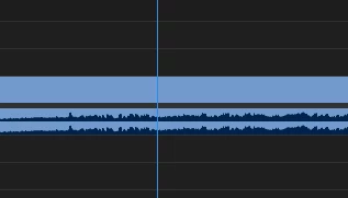

Jun 10, 2024 9:52 PM UTC
Sorry I used a bad example because I had to screenshot an old youtube video.
My premiere pro used to look like yours, where the audio was green and the video label was a different color.  Now they are exactly the same and I can't seem to fix it. But even if I change everything to PINK it both the audio and video come out blue.
