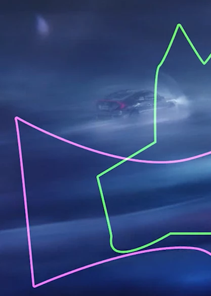

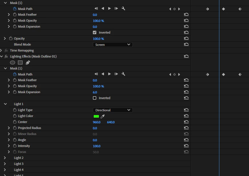

Feb 3, 2025 5:12 PM UTC
I found a way to apply a stroke to masks by using the lighting effect and copying my mask to the effect see bellow. Its actually the mask expantion that creats the outline however you cant use keyframes on mask expantion.
hope this helps

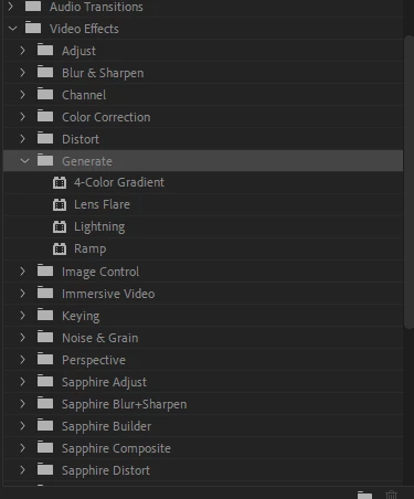

Sep 5, 2024 8:16 AM UTC
The Paint Bucket effect was removed in version 24.6 of Premiere Pro. You can find more details about the changes here: Obsolete Effects and Transitions
If you can describe what you used the Paint Bucket effect for, we can suggest alternatives.
