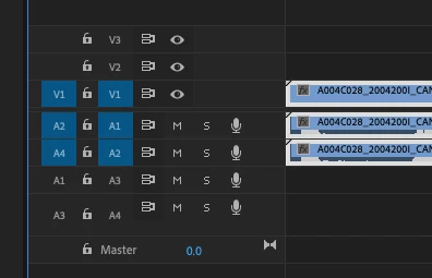

Can you post a screenshot showing your audio channels and patching?
August 31, 2020
Hello. Thanx for your answer.
Here are the screen shots. And, indeed, if I "v" the media source channels 3,4,5 and 6, then it works and I can patch my source A1 and A2 to any Audio tracks from the timeline.
But the idea here was to work with the mixdown in audio channel 1 and 2 only to facilitate the editing
