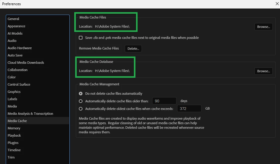

    I have had those issues on Windows as well and something i noticed that increases the risk of ending up in a loop of re-creating .pek files are to start working with media before the .pek files have been created.
    I solved it by closing all Adobe apps and then manually deleted the Media Cache Files and the Media Cache Database. Then i opened the project and did nothing in Premiere until all files were created.
    To find the files location: Go to Preferences > Media Cache
    I recommend having those files on an internal drive rather than an external drive/network/NAS/DAS.

    Hi. The Media Cache files are in the internal drive (tried default location from premiere and a different one I set up manually, no difference).
    I have also done as you suggested, just creating all the .pek files before doing anything else. Sadly, none of those things worked 😔

    Did you remove the Media Cahce and the Media Cache Database at the same time or only the Media Cache?
