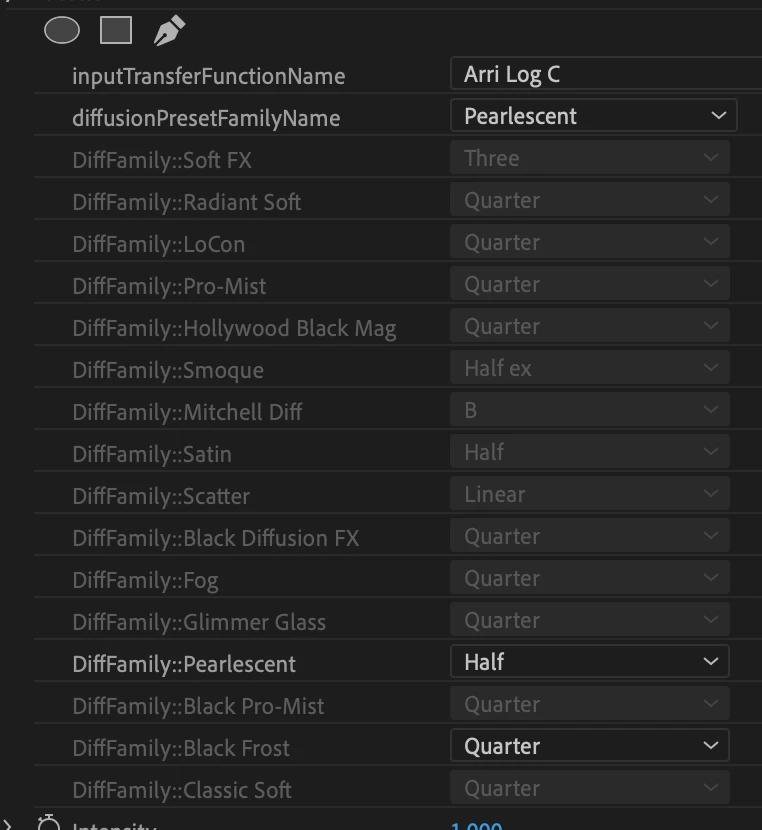

In my PremierPro plugin, I have one popup that controls the visibility of a list of `PF_Param_POPUP`.
So I set one to visible and all the other to invisible. This works most of the time but sometime, one does not get hidden !!!
I have tried changing the visibility in PF_Cmd_USER_CHANGED_PARAM when the controling popup change and them I moved the update UI logic in PF_Cmd_UPDATE_PARAMS_UI. But I get the same issue.

If I test the param.ui_flags that is still (incorrectly) visible, I see that the PF_UI_VISIBLE bit is correctly set but the UI does not honor this invisible flag.
Almost all my UI elements has the PF_ParamFlag_SUPERVISE set.

Unfortunately not. It happens one out of 10.
First I thought that was a out of screen popup causing the issue but not.
if I read back the ui_flags of all the control they are OK but the display does not match the ui_flags

If I use the flag PF_PUI_DISABLED, I have the same issue and we could see that the popup label is disabled but the popup itselt is still enable
