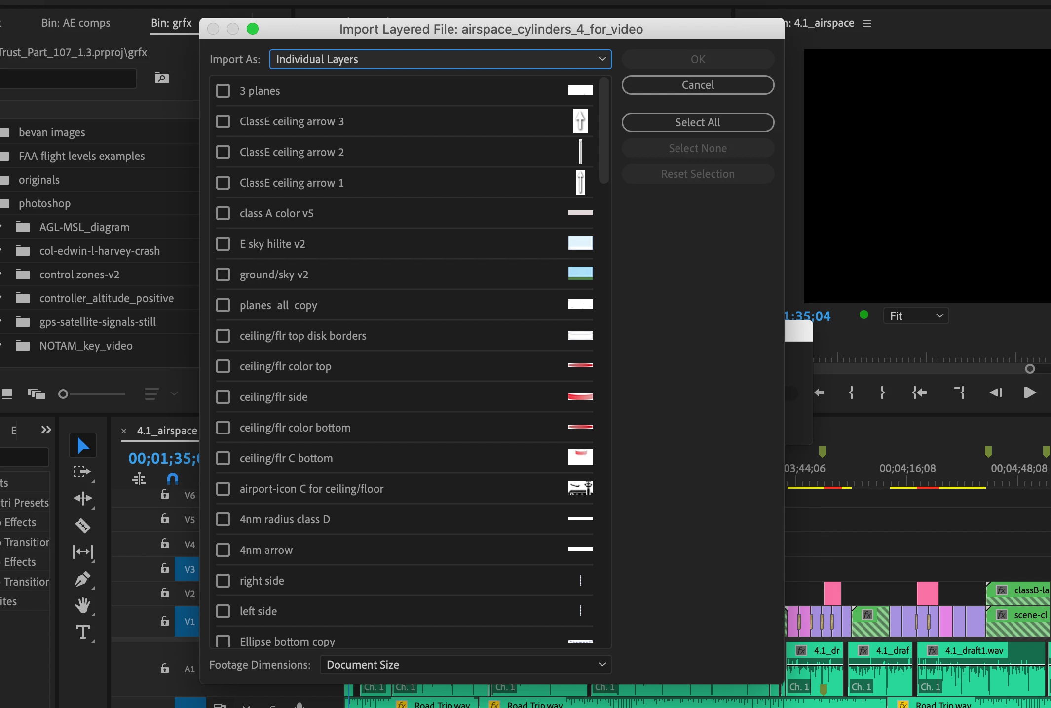

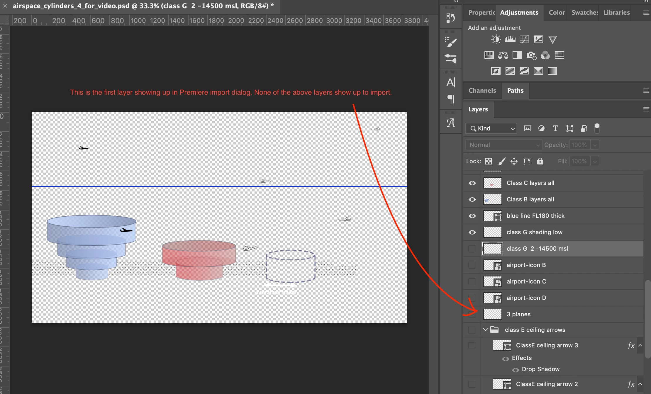

I'm using the latest version of Premiere Pro (14.8.0 build 39) and Photoshop (22.1.1) on MacOS 10.15.7.
Here's how it was working to import (dynamic link) Photoshop layers into my Premiere project:
- layers that were visible in Photoshop file (with file just saved) would show up as checked in the Import layered file dialogue.
- All layers would show whether checked or not.
Here's what is happening now:
- Some subset of the layers in the Photoshop file are showing up, starting some distance down the list of layers.
- The ones that are checked in Import dialogue do not correspond to ones that are visible in Photoshop.
This happened after I had to update the Photoshop file substantially after I'd successfully imported layers and built sequences in Premiere. I saved a new photoshop file, and just want to import it and rebuild the sequences. (have given up on just relinking layers to built sequences.
In the attached screen shots you can see that the first layer to show up in Import window is well down the list of layers and is not visible.
Would be grateful for any suggestions.

Thanks for the reply. I did not merge the layers. You can see them in the screen shot. Only those layers past a certain number down the list of layers show up in the import dialog. Replace clip only works with clips that are already in the project, and open in the source window.
When I try just relinking to the previous version of the .psd file from a missing item on the timeline, I get the "the importer reported a generic error".
I tried importing a copy of the .psd from a different location (downloads folder) but same issue. I tried renaming the file without underscores as I saw an old post saying that might cause problems.
Again, it is showing some of the layers but not all of them. What could cause this?
